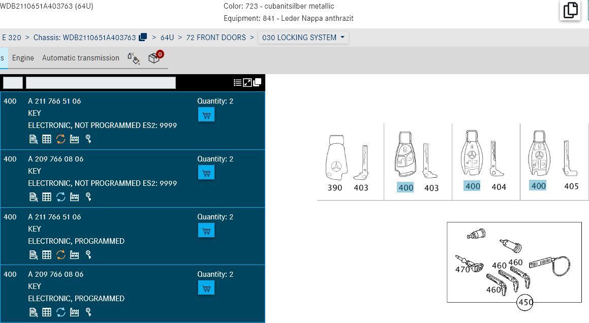

Hi all!
I have an 04 E320 with the keyless go package, however, both of the factory keys were replaced and now the keys I have do not have the keyless go feature, therefore I can’t use the keyless go in my car.
I’m trying to find some OEM keys have keyless go so that my mechanic can program them with my car. Any ideas where I can find the part numbers of such keys?
thnks!

Originally Posted by CastorTroy
afaik they can only be ordered from a dealer. they require proof of ownership, usually an ID and a copy of the registration.
I did get a quote from my local dealership in Costa Rica and it was around $1,000 and more than a month of wait since the key has to be shipped from Germany.
What I’m trying to do is to find a used key fob with keyless go but I’m having a hard time figuring out the correct part number.

VIN?

VIN?
The VIN is WDB2110651A403763

Not sure how you’re going to circumvent MB theft related part (TRP) policy but here you go.
Thank you so much!!!
