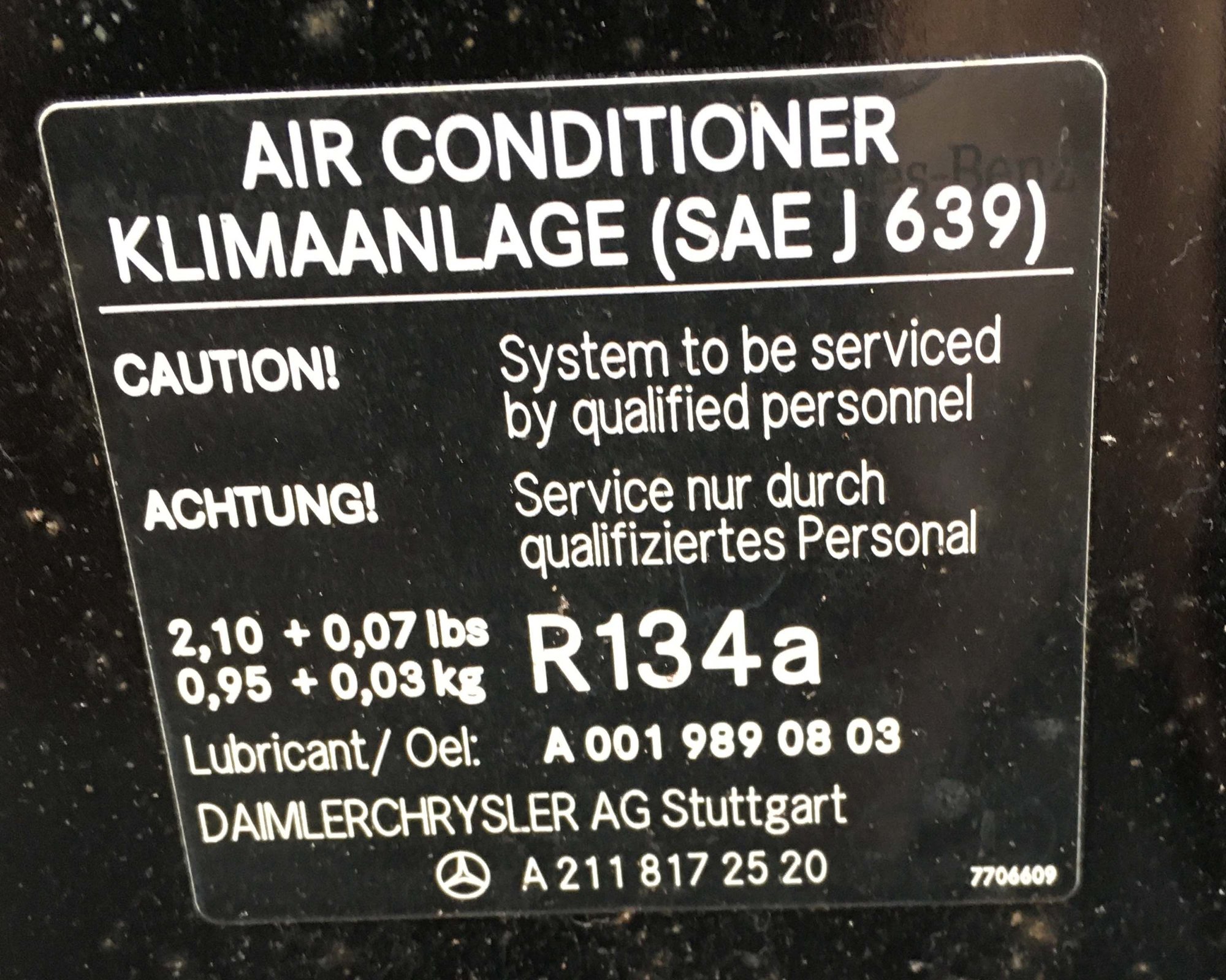

but always the left vents are colder than the right both front and rear. But more of this later because I have a fundamental question first about the refrigerant fill weight. It seems reasonable to assume that because the 4 zone system has more pipes and 2 evaporators, cars fitted with this option will require more refrigerant than the standard 2 zone model. However, I have searched far and wide and for the W211 I can find only 1 fill weight listed and that is 950g. On the S Class and predecessor E Class W124 I can see 2 listings, 1 as standard and a second for cars with “rear A/C”, the W124 takes 950g standard and 1150g 4 zone.
I queried this with the A/C guy and he said that he did not refer to any list but looked at the sticker on the underside of the bonnet which indeed states 0.95kg. Although he acknowledges my logic he claims that the sticker is irrefutable proof that has used the right amount of gas on my system!
Does anyone have access to any resource that would indicate that when the option was fitted the replacement sticker with 1150g was omitted!? That is my suspicion!
Any advice gratefully received however I think it reasonable to address the fill weight issue first then look at the other possible faults!?
