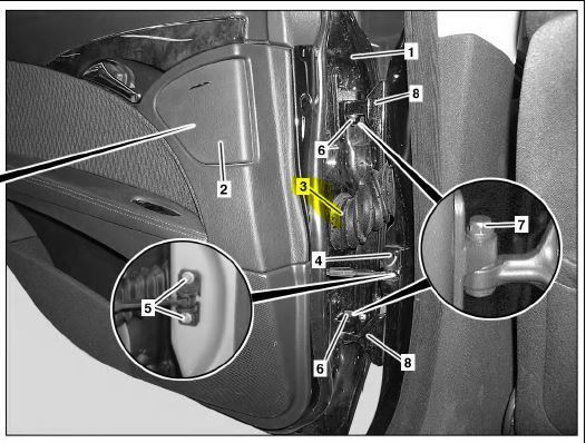

My driver’s side rear passenger window is not working nor the door lock. What type of module do I need to replace?

Check f32 @ interior fuse panel if fine, harness (3), last control module see compatible part #s to shop used.
