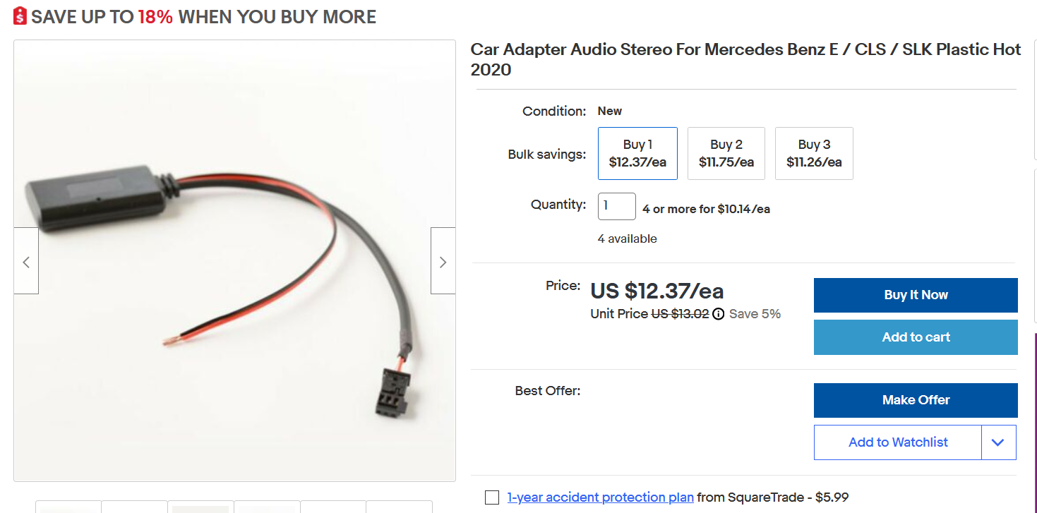

I own two of these vehicles and have the same problem. Hands free phone is OK but there is no clean solution to stream audio. One vehicle is getting a Dension system that replaces the CD changer in the optical loop. I am going to try the solution below for the second car. It replaces the aux jack in the glove box. Most phones can have multiple bluetooth connections, one for calls and the second for audio streaming.

I have a Bluetooth adapter plugged into the aux on my 2007 E550. Takes up literally zero space in the glovebox and works like Bluetooth does on any modern car
