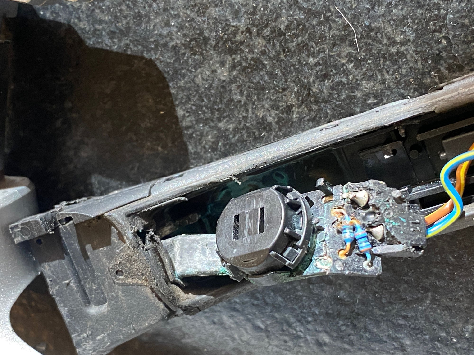

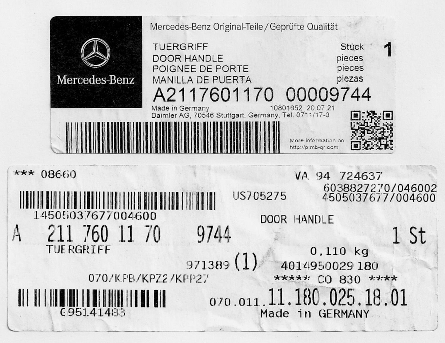

Hi, same issue here too with new Mercedes handle for driver side (front) of my 2005 E55 Wagon (see package label scan below).
There is no question that on the new part, which I tested with a DVM, the pull (open) switch engages the (nominal values) 470 ohm resistor, and the push (lock) engages the 300 ohm resistor, which is the reverse of what it is supposed to be, and the result is indeed that the open/closed functions are thus reversed. I pulled the old non-functioning handle apart—lots of corrosion inside—and found the two "old-school" discrete axial resistors (guessing 1/8W high precision type). This confirmed that the problem with the new part is that the resistors were installed swapped. I wondered briefly if the connector wires were reversed but from other posts/threads here, the simple two switch, two resistor circuit has no polarity.
I'm going to live with this odd arrangement... for now. It's clear this cannot be fixed in the external wiring, and it appears from posts above there is some skepticism from M-B that this is in fact a manufacturing error.
Will be interested to see what transpires. Is it too much to expect that M-B will eventually acknowledge/confirm there was an issue with a certain batch of parts, and they would then issue free replacements (with appropriate proof-of-purchase)?
Doesn't say much for the QC procedures with the OE supplier! Perhaps someone loaded the production rig with the strips (rolls) of resistors in the wrong order—if so there have to be quite a lot of these back-a$$ward handles out there!

Both labels on the new handle bag
Resistors (both 1%) revealed in old dead handle: On left, lock 470Ω. On right, unlock 300Ω

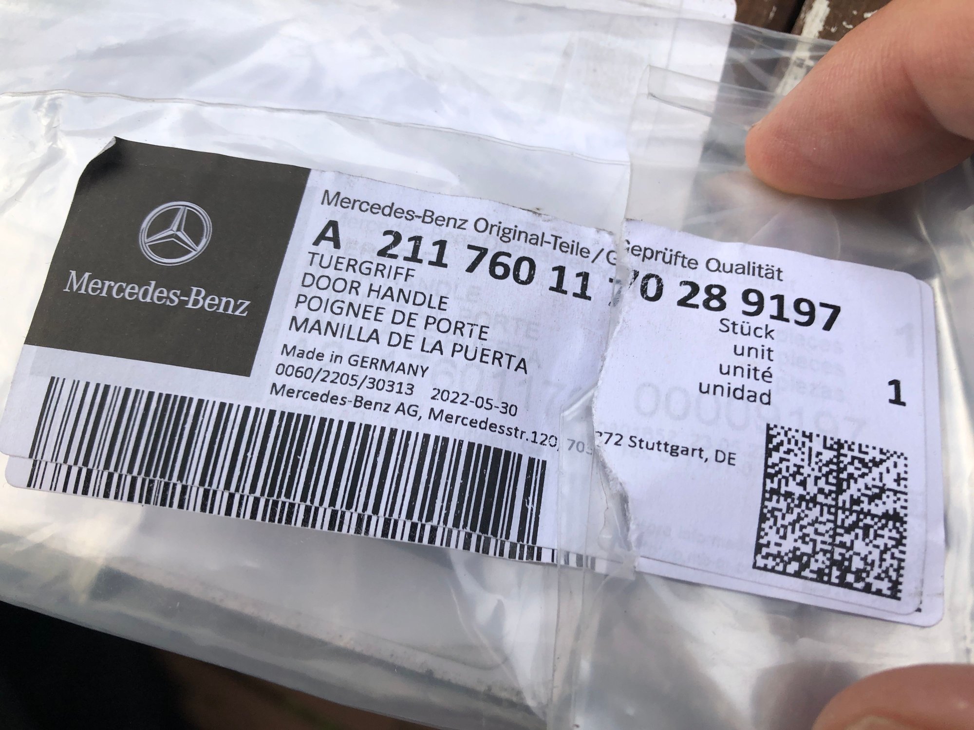

Anyway....I have the exact same problem, too. My 2007 CLK 350 (C209) also uses the W211 handle and I observed the same behavior. A quick internet search revealed this great thread. See a photo attached of my first handle that has the problem. I then went back to the local MB parts guy and he ordered a new handle for me. Today I picked it up and went to the service manager to do the resistance test and I also showed him the screenshot from the Star Diagnosis test instructions above. At first he was a bit grumpy but he then did the test for me and confirmed that the new handle has the same incorrect behavior. But he also mentioned that this screenshot is not matching what he is seeing in his software and that it's not the correct test and I would need to bring in the car to really test this, etc., etc. But it sounded more like excuses to me.
So I will go back to the parts guy (which I know very well) and return the second handle to get a refund and ask him if there is a process to report faulty parts batches. I will also ask the guys in my German forum if they know who is producing those handles and if there is a way to figure out which batch was affected, etc.
Also...I saw that one of you had posted a video on how to open the handle. So I wanted to know if there is a realistic chance to open the handle without destroying it, swapping the two resistors and putting it back together? I would prefer doing that vs. getting a used handle from eBay which then might break again soon, esp. if I would need to (re-)paint it before installing it. Not fixing my handle at all is not really an option....I hate having to get the key out of my pocket. :-) Keyless Go is really a cool feature.

To be honest with you. Trying to change the resistors inside the door handle is a bad idea. You will destroy all inside in order to get to the resistors (it is molded inside the plastic). It will become a nightmare.
My advice: Find a good used door handle. Focus on the condition of the rubber around the inner button and push button. If the resin is in a good shape = no water is there = no corrosion = will last a long time.
I've done the same. It works already 3d months. No issues.

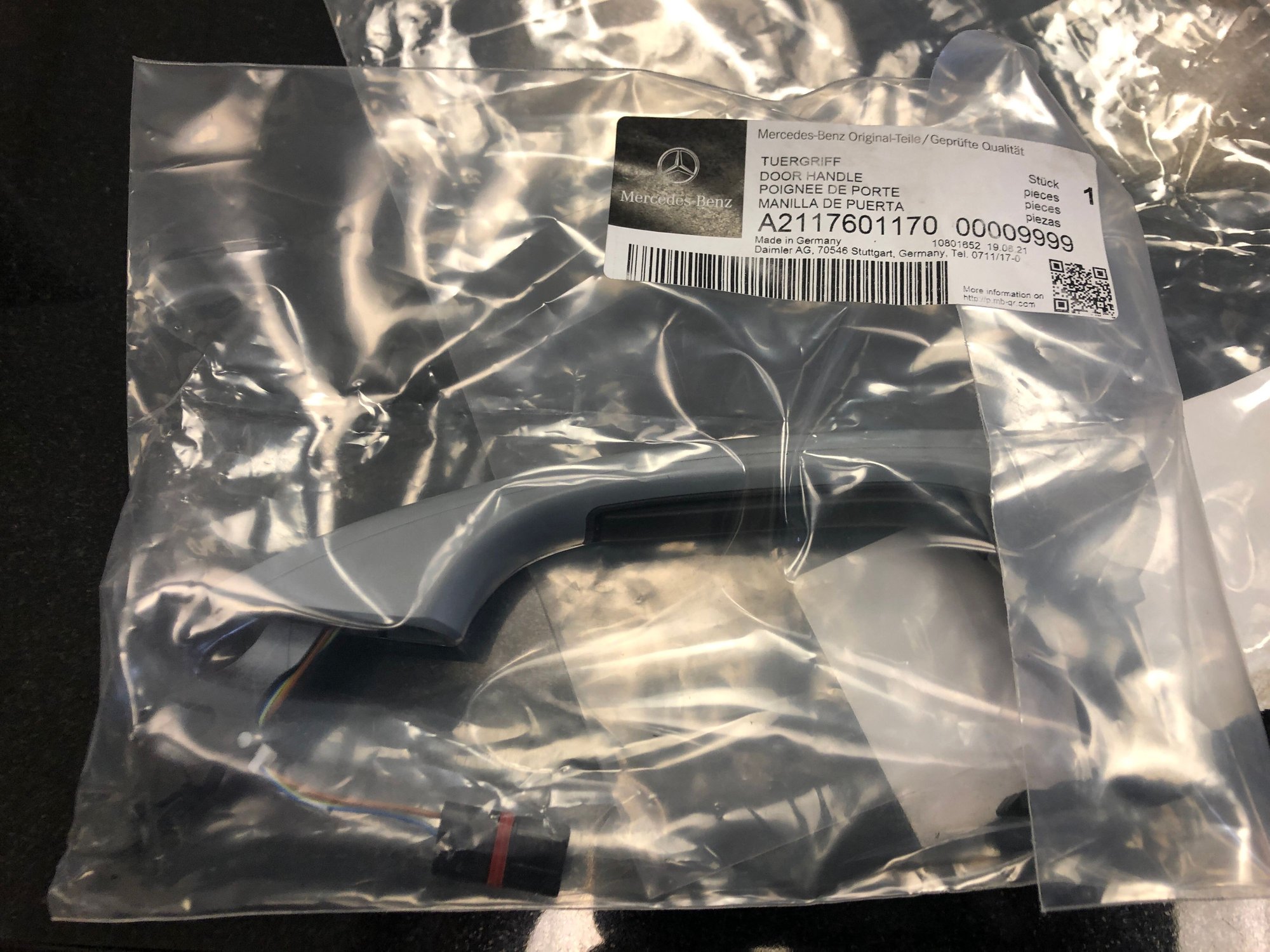

so 4 months later, I have now in total ordered 3 used handles from eBay, all "tested and fully working" according to the website. Only to find out that none of them had both buttons working once installed. So I returned all of them and luckily got all my money refunded.
But this week, I gave it another try and ordered the handle again at the local MB parts counter. He saw two handles available, one in the New Jersey warehouse and one in California warehouse. He picked the California one and....it's working!! And not not only that, he was suddenly able to order one of the (older) handles that come pre-painted (those ones have the 4-digit color code at the end). Those were not supposed to be sold anymore, the new handles all come in primer coating only and have to be painted manually. :-)
