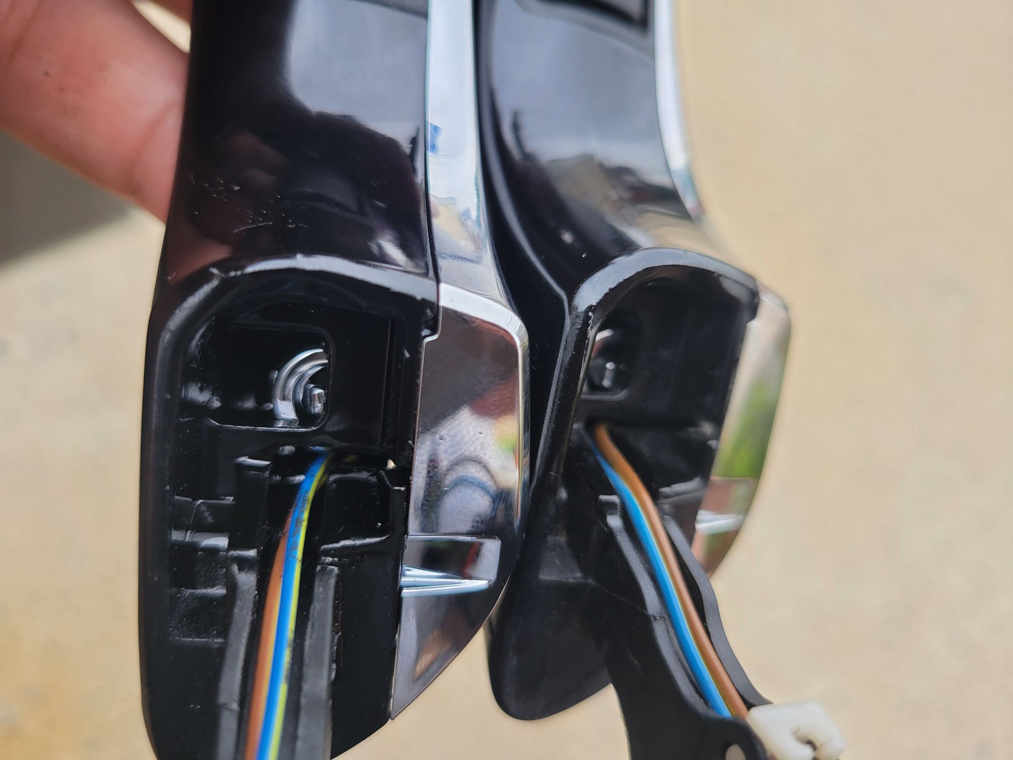

For what it's worth, I compared the wires from my original handle and the new one. The blue & brown wires are attatched to the connector in the correct slots.
However, you can see from where the wires are first visible, they are flipped. I checked this against the rear handle as well and it appears that only the driver's door handle is wrong.
(Replacement handle on left)
I'm going to replace the rear driver's side handle tonight and see if it's working properly. I really hope this one isn't messed up too, because it had to be ordered from Germany lol.

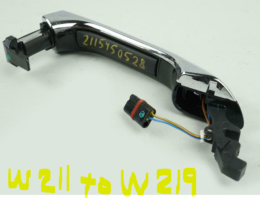

Today I've ordered a used one door handle of W211 from ebay. They looks identical(same platform). 50$ for used one instead 135$(also used one but from CLS).
When ill get it ill measure the resistance and will install it on the car. We will see if it will work properly.
If it will - using a deduction method and logic we were dealing with "factory bad replacement parts".
I will update later.
BTW here are some pictures. In the photo, you can see it is manufactured at the end of July 2021. Today is November 2021.
New replacement door handle sticker
swap from w211 to w219
