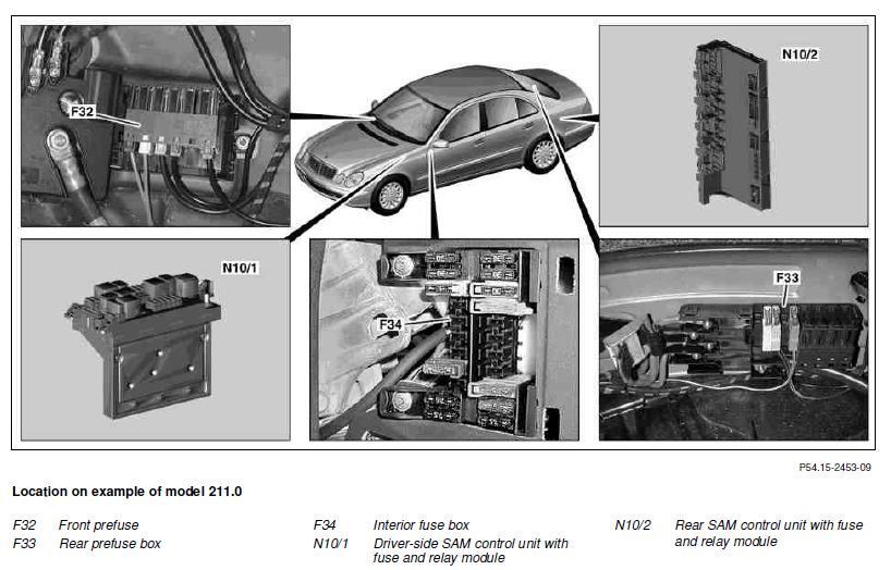

My 2007 regular E350 (not 4matic) has been having battery drain issues (dead by the end of the week). I have pulled all the fuses for seat controllers, audio, etc. but still drains. I tried to locate the battery control module but everything I google shows it by the battery in the trunk. Not there on mine. Can someone point to where it is on the later W211's? And mine does not have the aux battery which I assume is also a model year change. Thanks in advance

Best if you have someone with Xentry (MB diagnostics) track rest current, see attachments.

Yes, aux battery, BCM, and aux battery relay gone as of 2007.
After about 10 minutes rest current should fall < 60 mA if > 60 mA and < 1.2A via front pre-fuse box (F32) and rear (F33) narrow down the rest current path to localize the culprit, final rest current should must be < 60 mA.

Yes, aux battery, BCM, and aux battery relay gone as of 2007. After about 10 minutes rest current should fall < 60 mA if > 60 mA and < 1.2A via front pre-fuse box (F32) and rear (F33) narrow down the rest current path to localize the culprit, final rest current should must be < 60 mA.
Thank you konigstiger. As always you are a wealth of knowledge. An earlier current draw test was at 71 mA when in sleep mode. You have given me a path to follow.
