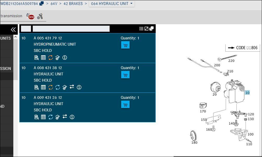

Can you help me out please. I own E220 2004, my car VIN is WDB2112061A509784 and I need a new SBC pump. I found new but I am not sure is it compatible with my car. New SBC pump nr is A0054319712, 0265250111.
Also what pump number should I have on it, not sure if its original SBC pump on my car.
Regards
Ando

'71 Pinto
File Type: pdf

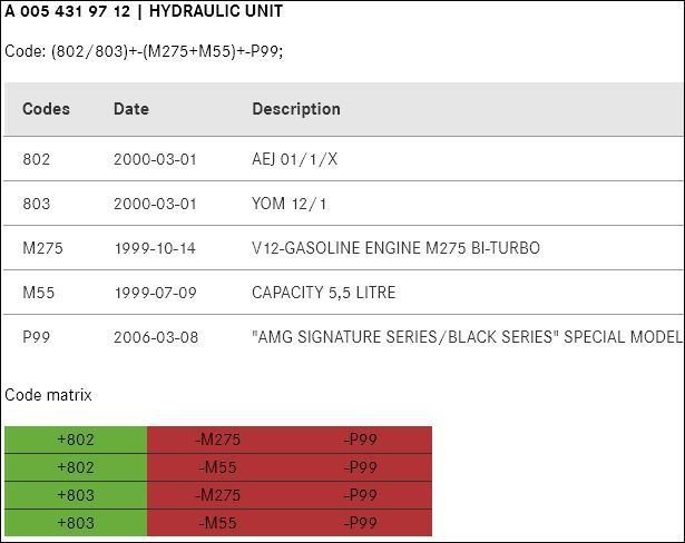

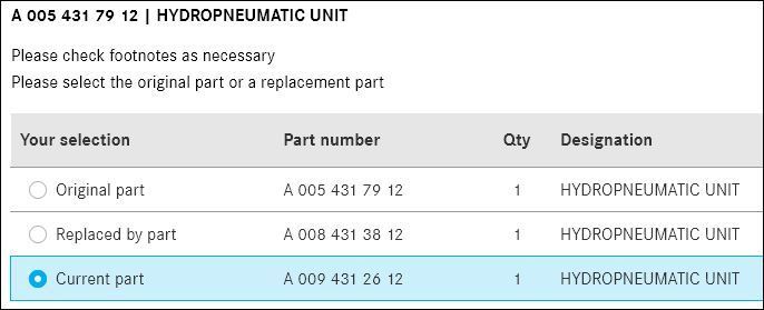

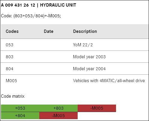

Hi
Thank you for your reply.
Just to clarify the part number what I would like to use is A0054319712 not A0054317912 if it matters. I dont know cars that well, so am I able to use that part on my car?
Regards
Ando

'71 Pinto
Part #s posted is what ISPUSA is showing as compatible, 9712 = 230 (M class).
