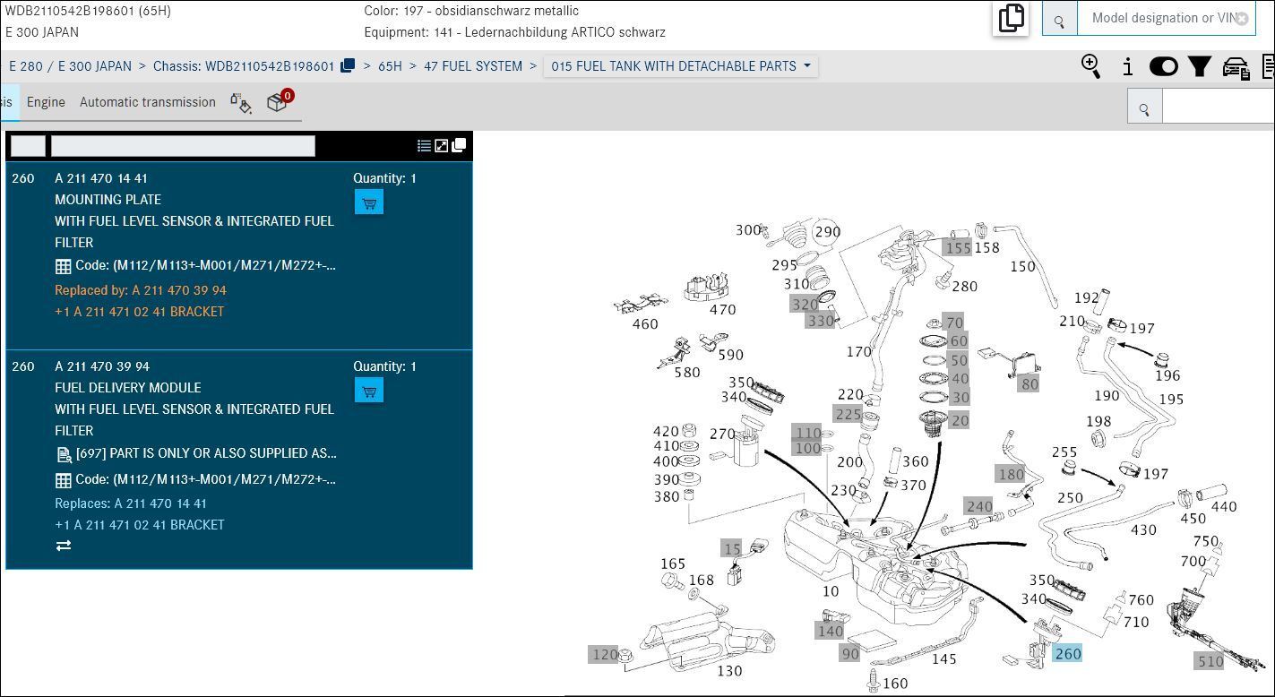

The fuel filter is housed in the driver side sending unit inside the fuel tank.

Thanks. Can it be replaced? Does it need to be replaced? I've seen some third-party filter sites state "Lifetime filter"

MB requires fuel filter replacement @ 150,000/15 years whichever comes first.
