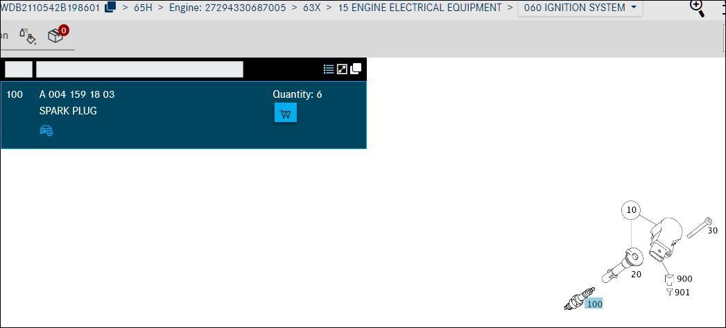

Hi
Yes, just took a look now. Hard to tell (with all the plastic covers), but seemed to be only one coil pack per cylinder.

Originally Posted by jave808
Hi
That is the M 272.943 engine
The engine with 12 is variant of M112, and it is in the E320, not the E280
