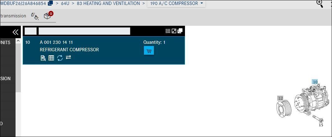

hello Konigstiger,
I need the part number for the a/c compressor on 2006 E320 CDI.
The electrical connector looks like it is fiber filled black plastic and has deteriorated, is flaking apart, no longer useable. Is there a part number for both male and female halves?
with the power steering above it its difficult to access it,
I hit a deer and it punctured the condenser, I had to drive about 150 miles without refrigerant.
Do you think the compressor will be Ok since it looks like there is no clutch.

WDBUF26J26A846854 and the connector I am referring to is sitting on top of the compressor, is 2 pin but only one wire is running into it.
thanks

Connector: https://www.ebay.com/itm/133279291755 if link fails search “133279291755”

To answer my own question about damage to the AC compressor without refrigerant while operating the vehicle. Because I don’t have a garage and hit the deer in the winter, I ended up putting about 2500 miles before I could replace parts in the spring. No damage to the compressor occurred, still holds refrigerant a year later. I added some UV oil just in case. I replaced the valves in the ports to make sure I wouldn’t have any leaks, but I had leaks somewhere while doing pressure and vacuum tests. Turns out all 10 valves purchased from Amazon were defective, so the old ones went back in. I had trouble weighing in the refrigerant when the temps were 50F, couldn’t get enough in, was taking forever. The next day it warmed up to ~63F and I got the remaining in. The parts I replaced were the condenser and the drier which is the long cylinder mounted to the bottom if the condenser and the electrical cable on top of the compressor.
