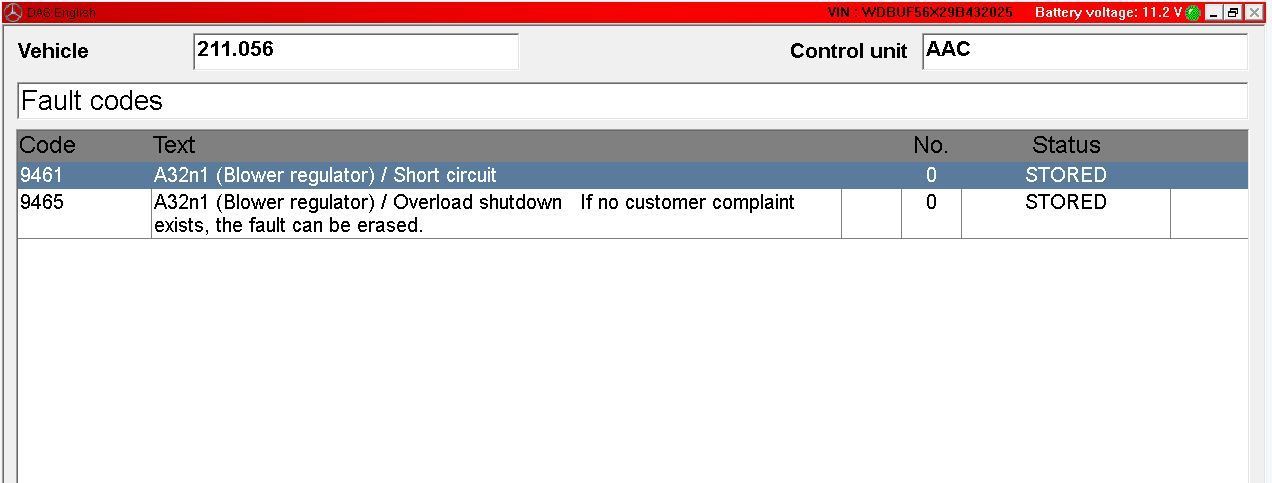

I ran it through STAR and see this message pressently as a stored fault. Is this why the blower motor is sometimes turning on or at a delayed reaction? The blower motor regulator is original to the car (13 years old) and I figured I didn't have to change that when I changed the blower motor because I had never experienced this problem before... Just seems strange that this is the case. Note that the car hasn't been driven during the winter. So it was under a cover plugged in for the 2-3ish months.
STAR Fault:
If I go through the reset in the HVAC control I can hear things happening and then the blower works fine. As soon as I shut it off, then turn it back on ,it either doesn't blow, or it's delayed by several minutes.
I just wanted to be sure before buying an OEM blower motor regulator to make sure that my thinking is correct.

I leave it in auto mode and fan mode set to 3 or 4 and it start immediately when the car starts. Sometimes it stops midway other times it just keeps blowing. I haven't got a clue why it is doing this. I've replaced the blower motor 3 times now all being brand new OEM. I've replaced the blower motor regulator2-3 times all being OEM. I can run STAR diagnostics, and everything checks out fine. I tend to keep the temp set now at around 74 or so. I've noticed if I turn it up super high or super low then it decides to not turn on. When I was getting errors, it would mention the blower motor regulator.. but I find it very hard to believe that two times being replaced with OEM and being new there would be a problem. I'm just chalking it up to German over engineering. My 17-year-old Toyota Solara has never had an issue like this at all nor have I had to replace the blower motor or regulator..lol. I turn it on and it just always works. Part of me likes the simplicity of that, while the other part finds that the Germans tend to overcomplicate things that don't need to be an issue, but then turn into an issue because of how they engineered it...
