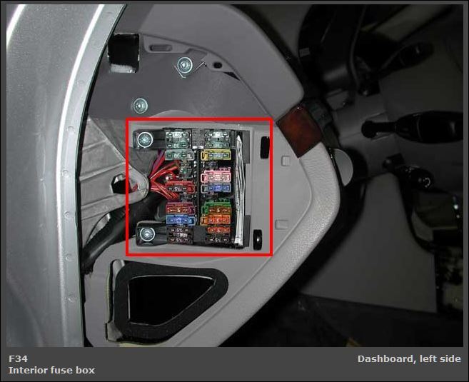

Again, odd that all four actuators would fail in this manner simultaneously. Consider checking associated fuses @ interior fuse panel: f21 right rear door control unit, f22 right front; f32 left rear, f33 left front. Pull each for a minute or two and reinsert. Unsuccessful, remove fuse panel inspect connections. Fine, move on to CAN connectors.

Started pulling each of the door controller fuses and found that, although all 4 door locks “pulsated”, the bad actuator was the drivers door. To temporarily fix the problem, I wrapped the door button with one layer of electrical tape. This put enough friction on the button to allow the locks to function properly. I plan on buying a few actuator springs to fix the problem permanently.
