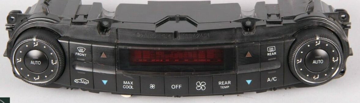

On the button side, I do not have it either and why I advice to press the AUTO button instead. Do you have the AC control as this one:
That is the one I have been working with. Not certain why it is in this model since it seems is the standard for the W219 (CLS500/55). Perhaps because it is the Elegance model?

Would you mind posting a photo of the AC control unit on the dashboard? We (forum members) can then understand what system is in your vehicle (your VIN number would help as well)

From VIN, and the photo it seems it is a 2-zone Tempmatic system which does not have the hidden menu
