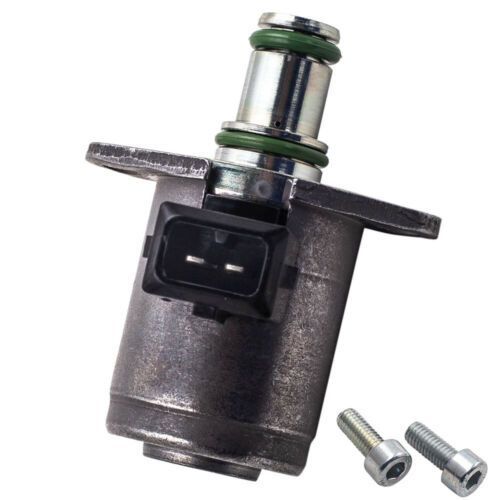

You don't need to replace the entire steering rack. You can just replace PWM solenoid that controls the variable assist.

Hi, There, I'm new here. I have a couple of car issues that are driving me crazy. I have a 2006 E 350. I never knew anything about engines and had zero mechanical skills. After my engine began to run very rough, I took my car to a dealership for a check-up. I was told that I need to replace my balance shaft and it was going to cost me over $6000 to fix it. I didn't know what Balance Shafts were but I knew that I had no more room for an additional $7,000 debt. Some of you might know what's that like. Anyways, I bought some tools and began to work on my car. Thanks to YouTube and the internet I was able to replace the balance shaft, time the engine, and put it back in. But, then I noticed this loose wire coming out of my rack and pinion solenoid valve (speed sensor, I think). I have been pounding my head to find out where the loose end of this harness connects to. Is there someone here who might know where the other end of the engine wiring harness connector to Selonoid goes? I very much like to finish this car and start driving it again. The harness is numbered 300 in the figure below.
