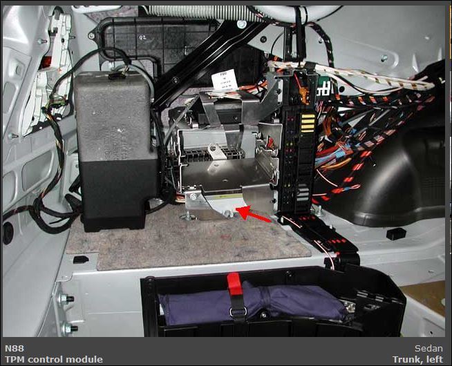

Hi All,
Anybody know where is the TPMS module locatin for w211 2007 E350?

Old Sep 5, 2022 | 12:54 PM

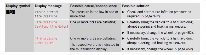

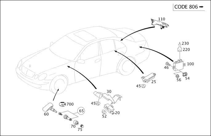

Originally Posted by Ehabmj
Hi, Anybody can share with me the W211 E350 2007 TPMS Wiring Diagram and controls locations please!
Provide VIN so I can identify which system you have, see attachment for basic overview.

Thank you again, so my can it doesn't have TPMS on it, I am trying to add the whole system and try to see if it will work?

Vehicle is already equipped with tire monitoring however, does not include individual tire pressures. Tires are monitored for rotational force rather than inflation values. Advanced system (only available in Canada for 2007) would require tire sensors, antennas w/brackets, control unit, harnesses to wheels & CU, and Xentry (MB diagnostics) coding.
