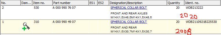

The yellow is my car, the white line is for a bolt that corresponds to the above rim from 2020 E350, would this be an issue for my car or is it just showing the size of the bolt required for 2020.

It is not only about tire size, but also offset and bolts. Since your car is 4matic, you want to be as close as possible to specifications. This topic has been discussed for several models in the forum.

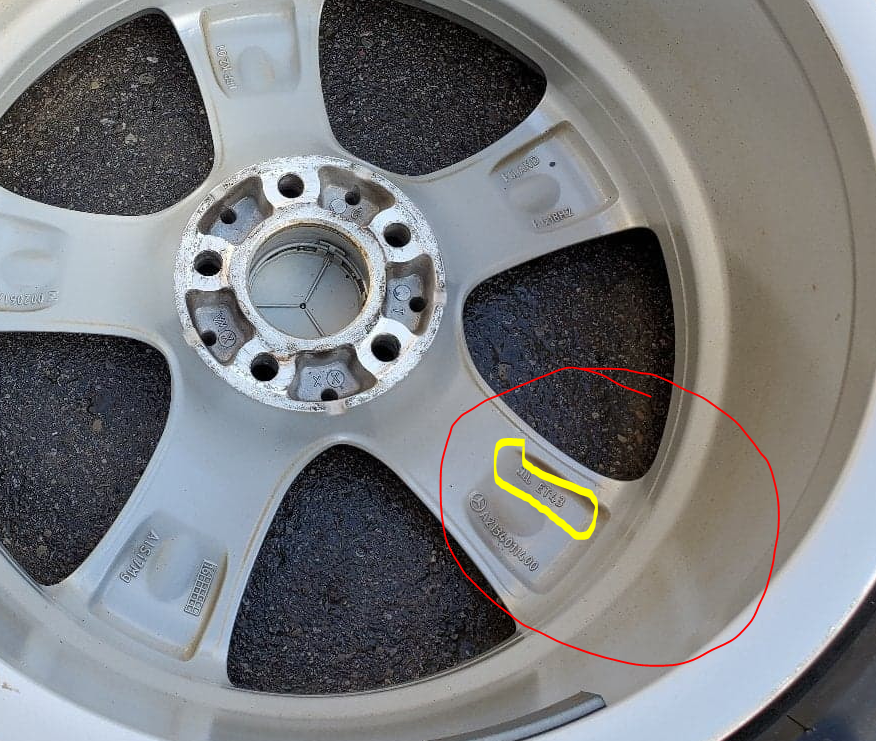

For the offset, the number highlighted is the one for those wheels

I went to see the rims last night and i definitely need the longer bolts from the 2020.
In the top link i compared the two ET. thank you for the 4matic reminder, I will pass on these rims then.
