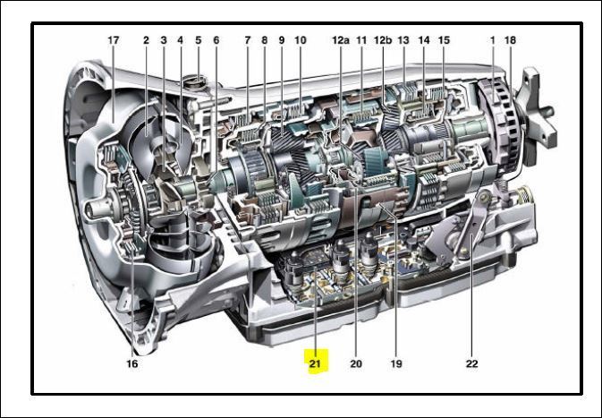

Does anyone know the location of the TCU/TCM for 08 E350? Thank you.

On a 5-speed it's located under the passenger footwell floor (pull the carpet etc.) and on a 7-speed inside the transmission.

722.9 module is inside transmission (4matic = 722.6).

Mine is not 4Matic. It's not under the glovebox. It must be inside the transmission, module 722.9
Correct.
