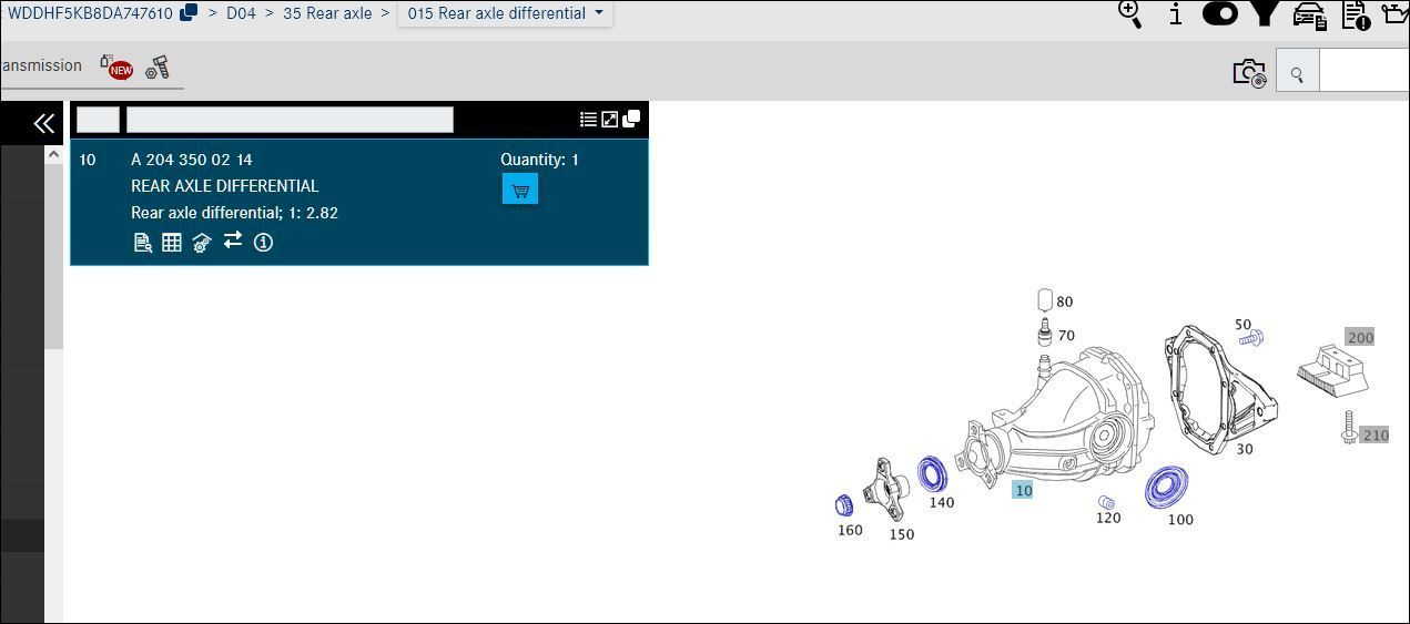

Originally Posted by AllPhonesAretap
I'm NGL I think the diff on my E350 is on the way out( I changed the fluid and chunks came out). Since we're on the topic, if you don't mind, my VIN is WDDHF5KB8DA747610 thank you in advance Konigster
File Type: pdf

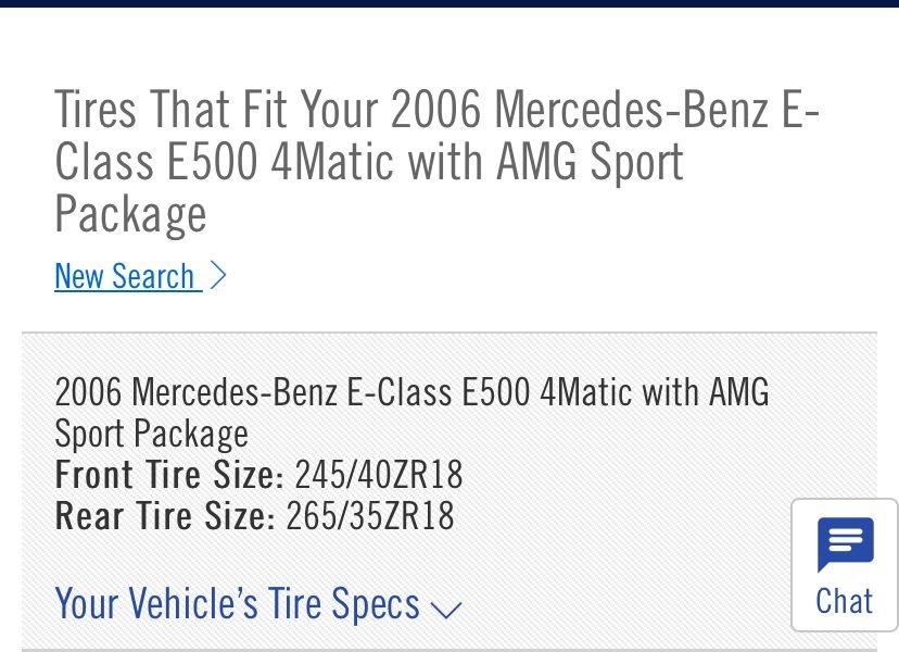

Originally Posted by E55Greasemonkey
It's very rare for the rear diff to go bad. You can find one on Ebay but make sure it's the same gear ratio! It's not a fun job to replace it either. I'm also concerned that your wheels are not original and appear staggered. 4matics must have the same diameter tire all around or you will damage the transfer case. It looks like you may have the same size tires but on different width wheels as the rear tires look stretched? These cars are also known to destroy the front CV axle boots often as well as the front diff u-joint which will cause catastrophic damage when it breaks.
you might be right about the wheels being staggered. I came across this online…. There’s very little info online about the AMG Sport package and the cars not with me right now for me to check the sticker on the door. But I’m trying to confirm now

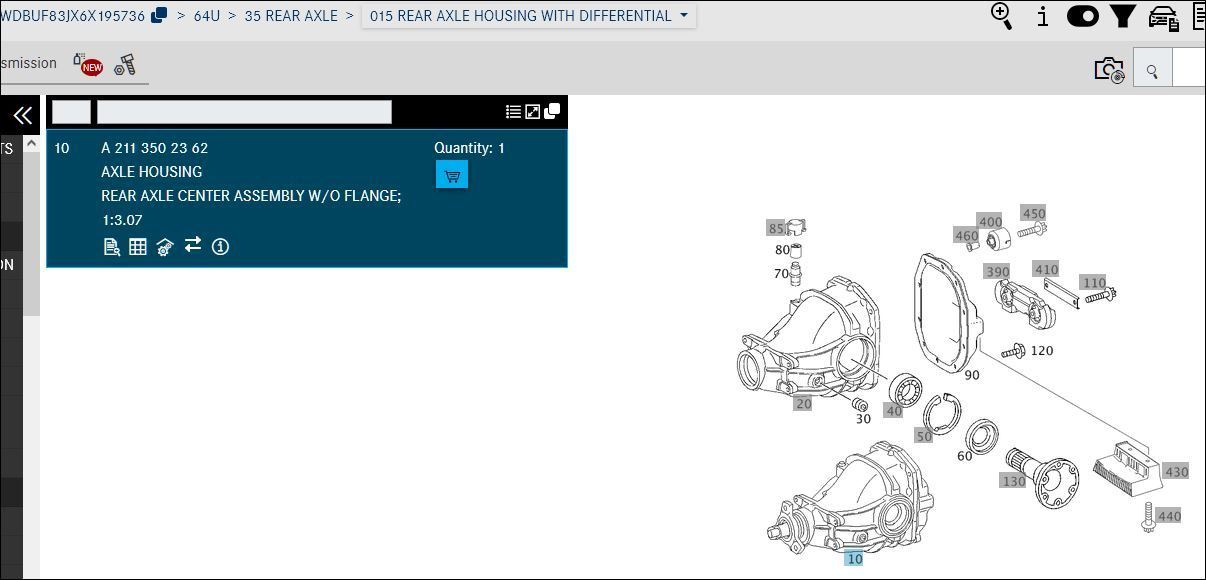

File Type: pdf
I can't recall seeing any MB of this era with 4matic and staggered wheels/tires. Even the 4matic sport/AMG package cars would run 4 "front" wheels/tires on all 4 corners. I looked up your VIN and your car does have option code 791 "AMG 5-spoke light alloy wheels." Interesting. Take a picture of the tire pressure label on the driver's door b-pillar it will tell you the factory tire size. The parts film confirms for your VIN those are the correct design wheels, and you should have 18x8 ET30 on all 4 corners. There is always the possibility the previous owner damaged a wheel and replaced it with the same style wheel, but the wrong width.
