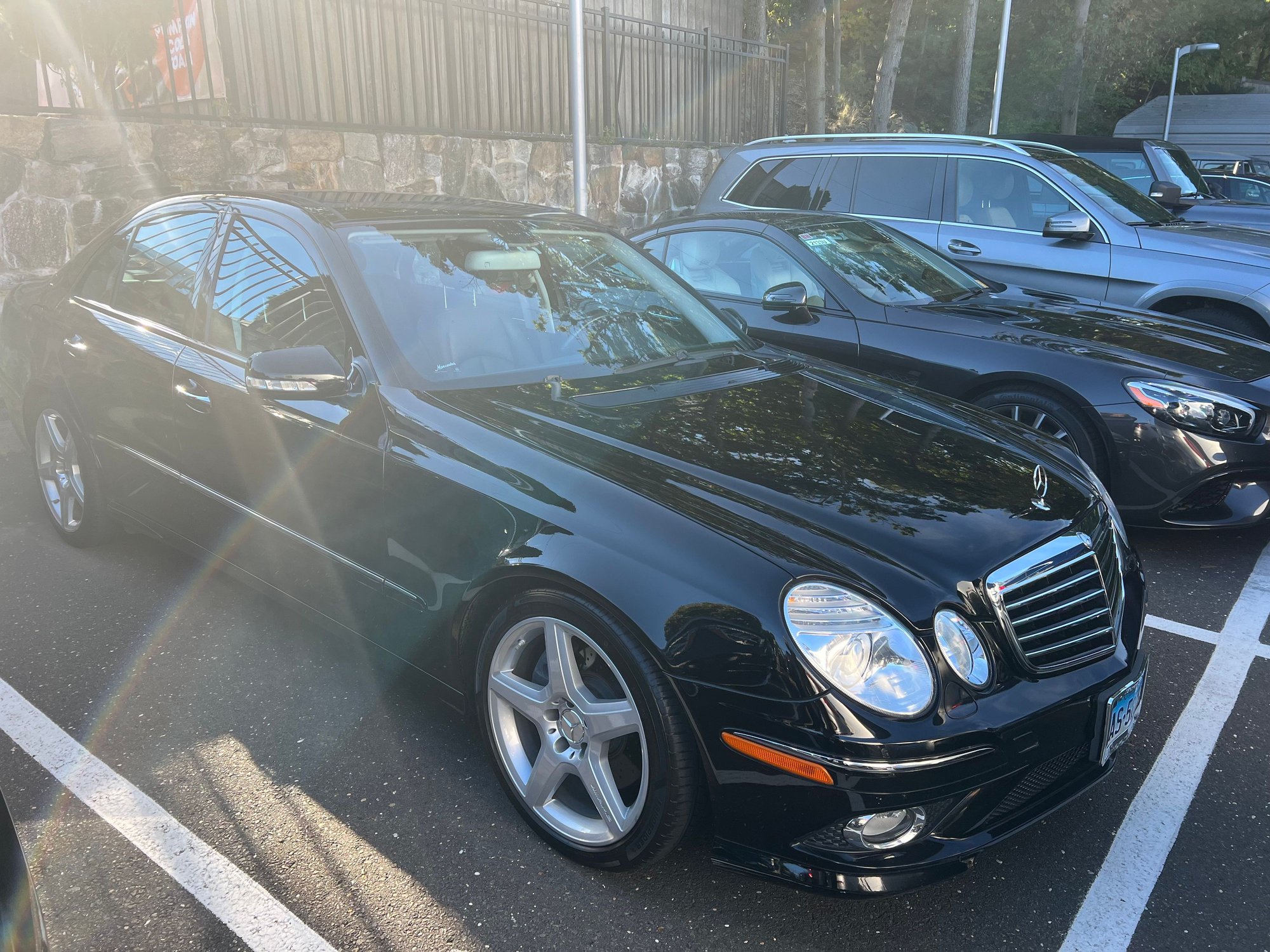

Hello everyone! First timer here just wanted to get familiar with the thread and seek some help,
I just got myself an '09 E550 4-matic with the AMG sport package after driving an '06 E500 for around five years. The car was owned by a family friend since new, regularly serviced, and only has 60k miles.
The car itself is mechanically and cosmetically mint, but unfortunately I'm having some trouble with a few interior components. The rear window sun-blind as well as the rear portion of the panoramic shade are having some issues-- the sun-blind itself doesn't want to go up, and the panoramic portion stops about halfway on the track while the front half rolls all the way back. If anybody has any advice/links to a forum that could help I'd greatly appreciate it!
