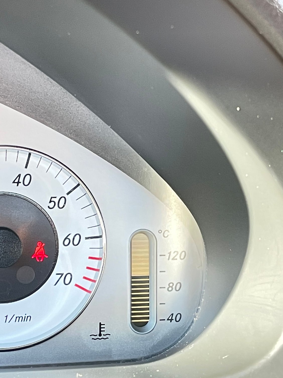

1st time posting and searched. I have an 08 E350, my 1st Merc and my 2nd German car. Recently replaced my thermostat and this morning the temperature went well beyond 80C. Outside temp was in the low 40’s. Reason for thermostat change is a P0128 code. Is this normal? Before the replacement, temperature only rises to just above 80C.
Thanks!

I'd say normal. The old thermostat likely allowed more uncontrolled coolant flow, thus keeping the temperature lower. The new thermostat doesn't suffer that issue.
Worried? Find a good long uphill run and flog it while watching the temperature gauge closeley.
