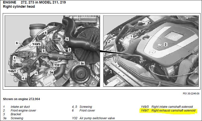

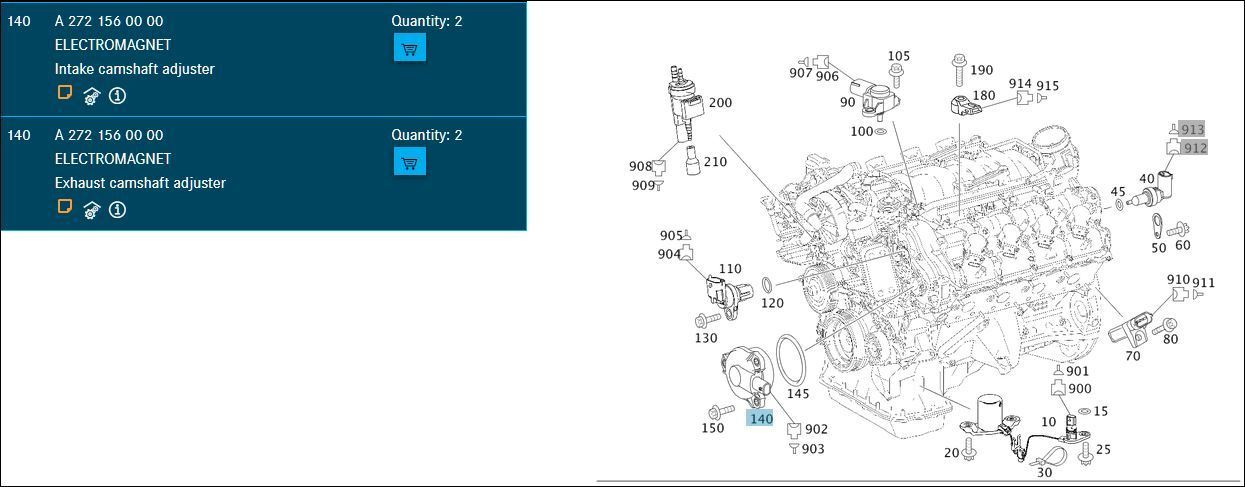

0732 - The position of the exhaust camshaft (cylinder bank 1) deviates value. Check harness/solenoid for oil if so, have MB dealer check Vehicle Master Inquiry (VMI) to confirm Service Campaign 2012070002 was completed if not you’re entitled to free adapters. No oil, solenoid may be failing. If solenoids were never replaced (again check VMI) then I recommend replacing all four one time.

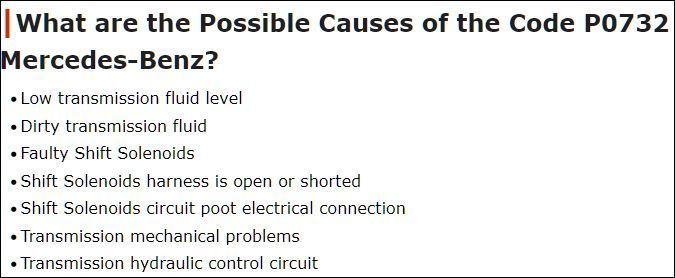

but the code does not refer to that it’s giving me transmissions codes gear 2 incorrect ratio

Ah yes think I remember, non MB code and suggested:
yes I had got a new conductor plate gasket and pin connector installed with fluid change from a Mercedes shop and now I’m getting that’s code
