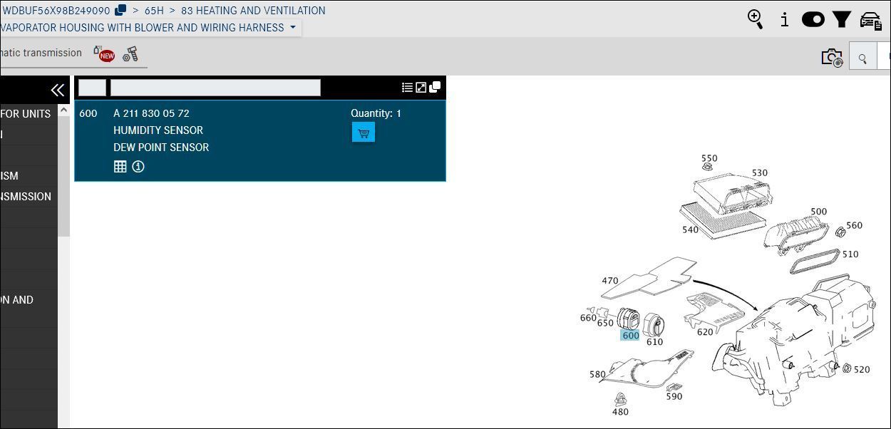

Originally Posted by gogydm
I know there is a TSB for these newer cars to get a humidity sensor fitted, but I don't have the cutout for it.
Interesting, EPC shows VIN as equipped with sensor. Anyway I agree check refrigerant level.

Thanks for the quick reply. I am looking in the cabin air filter box and it’s not there. Is there anywhere else I’d need to check? I know that the 4 zone cars have a fancier sensor but my car shouldn’t have that. I am
thinking of firing up Xentry and checking if I have a reading for humidity.

Even MBUSA EPC sometimes is wrong best to check with Xentry. Again, may be as simple as refrigerant level.
