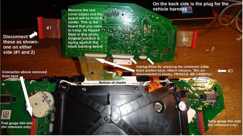

Ideally new OEM IC need to transfer data using MB diagnostics however, DIY swap circuit board from original to replacement. Provide VIN I will pull part # installed.
File Type: pdf
