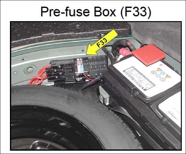

Yes, moisture is a factor BCM & rear pre-fuse box is located here.

so what do you think my options are to fix this because both of the pics you guys posted are exactly where the waters at, and i only have the issue when its rained quite a bit. aLso my batt terminals look kinda of bad like almost all white from whatever crud got on them so im thinking maybe i should try changing those out too?
