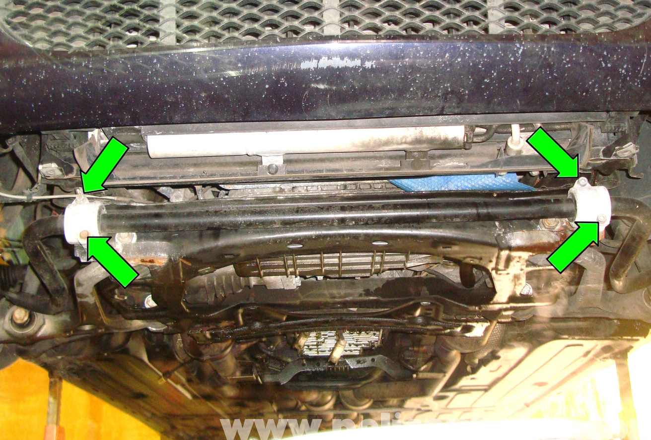

I wouldn't be surprised if it is the swaybar body-side mounts.
Reply 0
Apr 2, 2023 | 07:36 PM
Quote: I wouldn't be surprised if it is the swaybar body-side mounts.
Are you referring to these?
Reply 0
Apr 2, 2023 | 11:58 PM
Yes, if you have 4matic. Looks a bit different for RWD versions but same idea.
They cause all sorts of weird sounds and seem to be missed by people diagnosing noises.
Reply 0
Apr 3, 2023 | 12:17 AM
Quote: Yes, if you have 4matic. Looks a bit different for RWD versions but same idea.
Thanks! I am going to try lube up one more ball joint by the hub and see if that does anything - then I'll turn my attention to this.
