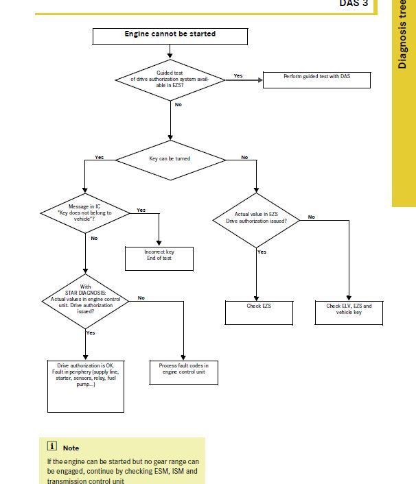

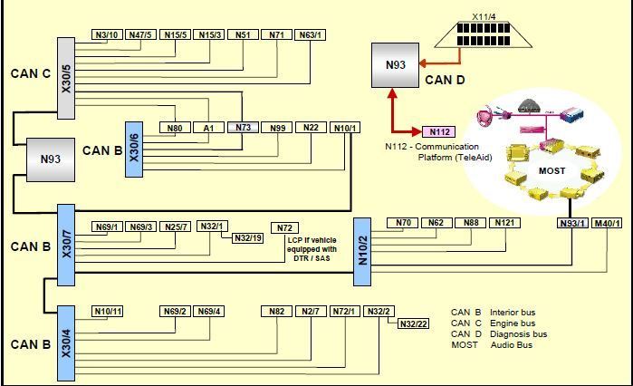

The electronic ignition switch (EIS), the steering column lock, motor electronics (ME-SFI, M3/10), and driver's side SAM (N10/1) are all connected via junction blocks X30/5 and X30/6 so they do not need the CGW to communicate protocols to each other. It is possible the signal to activate the starter relay on the front SAM would pass through the CGW but I feel like this needs more digging. I see nothing in the documentation showing the CGW being involved in the start process.
A good battery is essential. Do not have the key fob in the EIS when you attach jumper cables or a new battery; the voltage spikes can and will blow fuses and possibly damage modules.
You need STAR/Xentry to run a serious diagnostics test; that alone would give you info to reassure you about the health of the CGW. Find an independent MB mechanic if you can, repair, then sell the car and buy something reliable. Not dinging you, it's that I own a pair of older Mercedes and know the costs involved.
