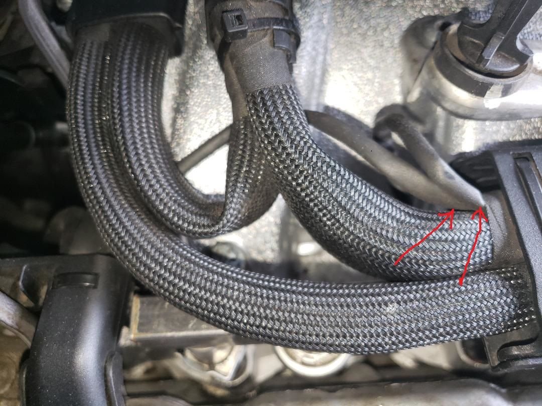

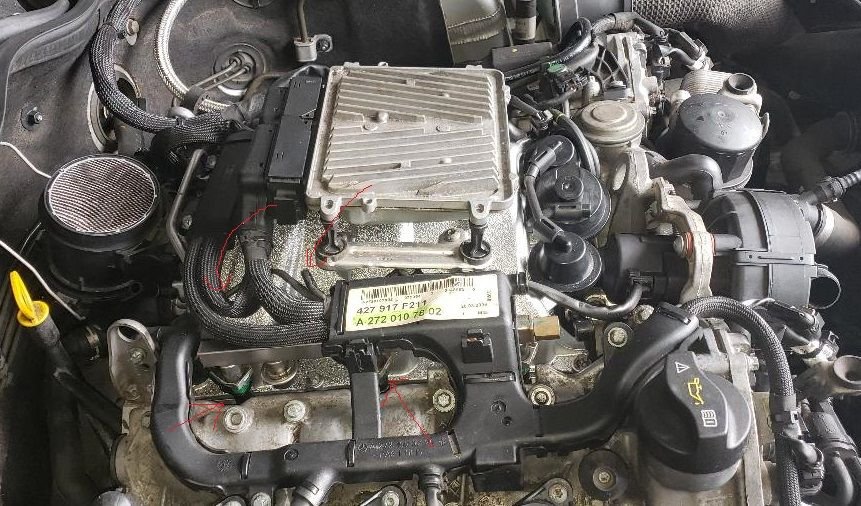

I am also concerned that on the passenger side that the two fuel injection rail connectors may be got swapped. Can someone confirm this connection is correct?
two wires at source
The top two arrows point to the wires that go to fuel rail connectors marked by the other two arrows at the bottom.
