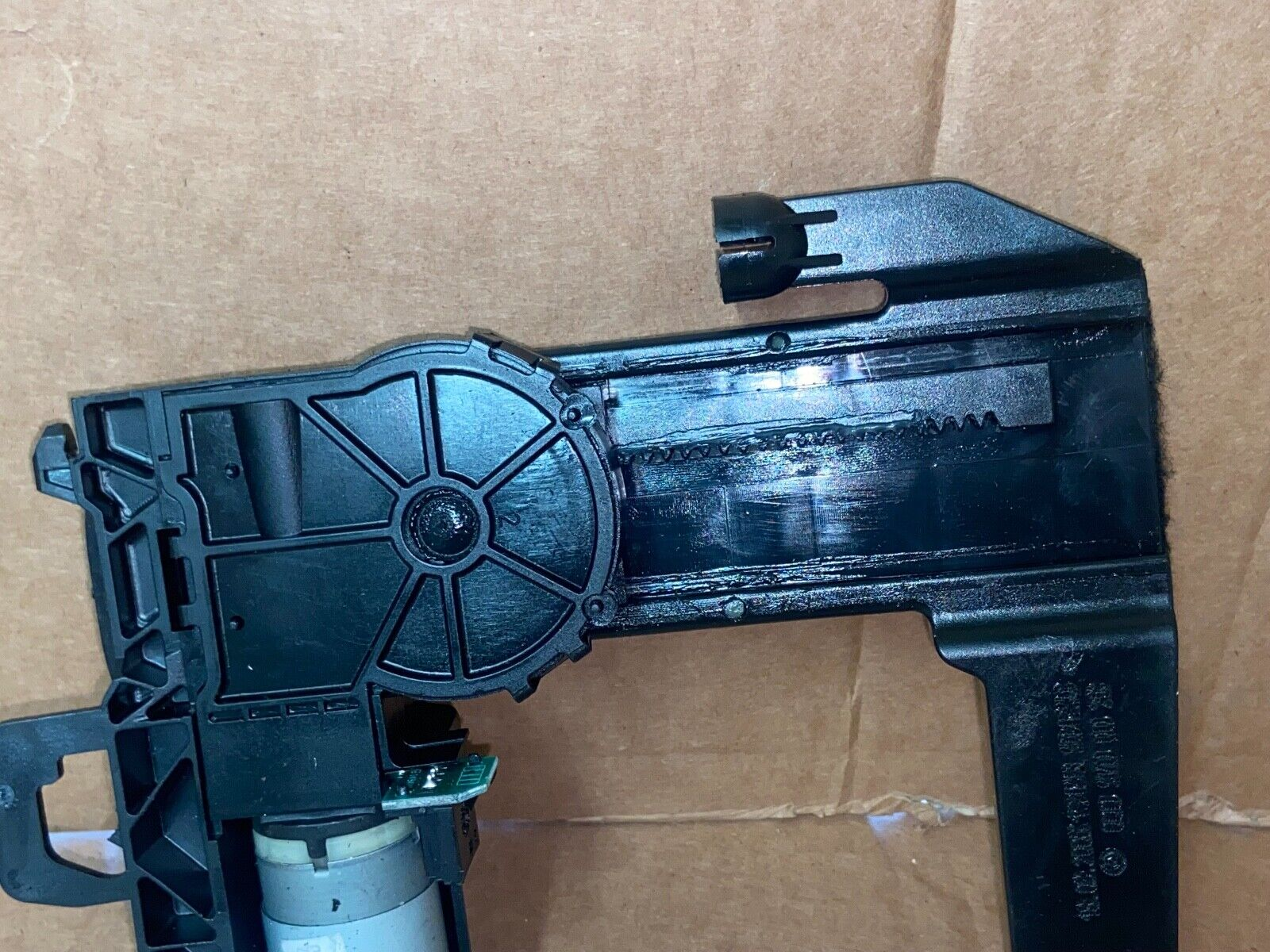

My driver's headrest stopped working. I can hear a relay click under the seat when I hit the button. All other seat motor functions work. I pulled the motor out and tested it, it does spin when I apply an alt power source. Any idea what the next step should be?

Check the headrest slides up/down with ease w/o the motor. Those motors cannot move anything with a lot of resistance.
Have you isolated the source of the click? Perhaps the gear mechanism is stuck? broken internally? dried lube?

It moves smoothly. The click is coming from under the seat-module I believe. Sounds the same as when I hit one of the other seat adjusting buttons, but nothing happens. The motor does not work when plugged in where it's supposed to be (I tried it loose, not attached to the gear assembly so that there would be no resistance)
