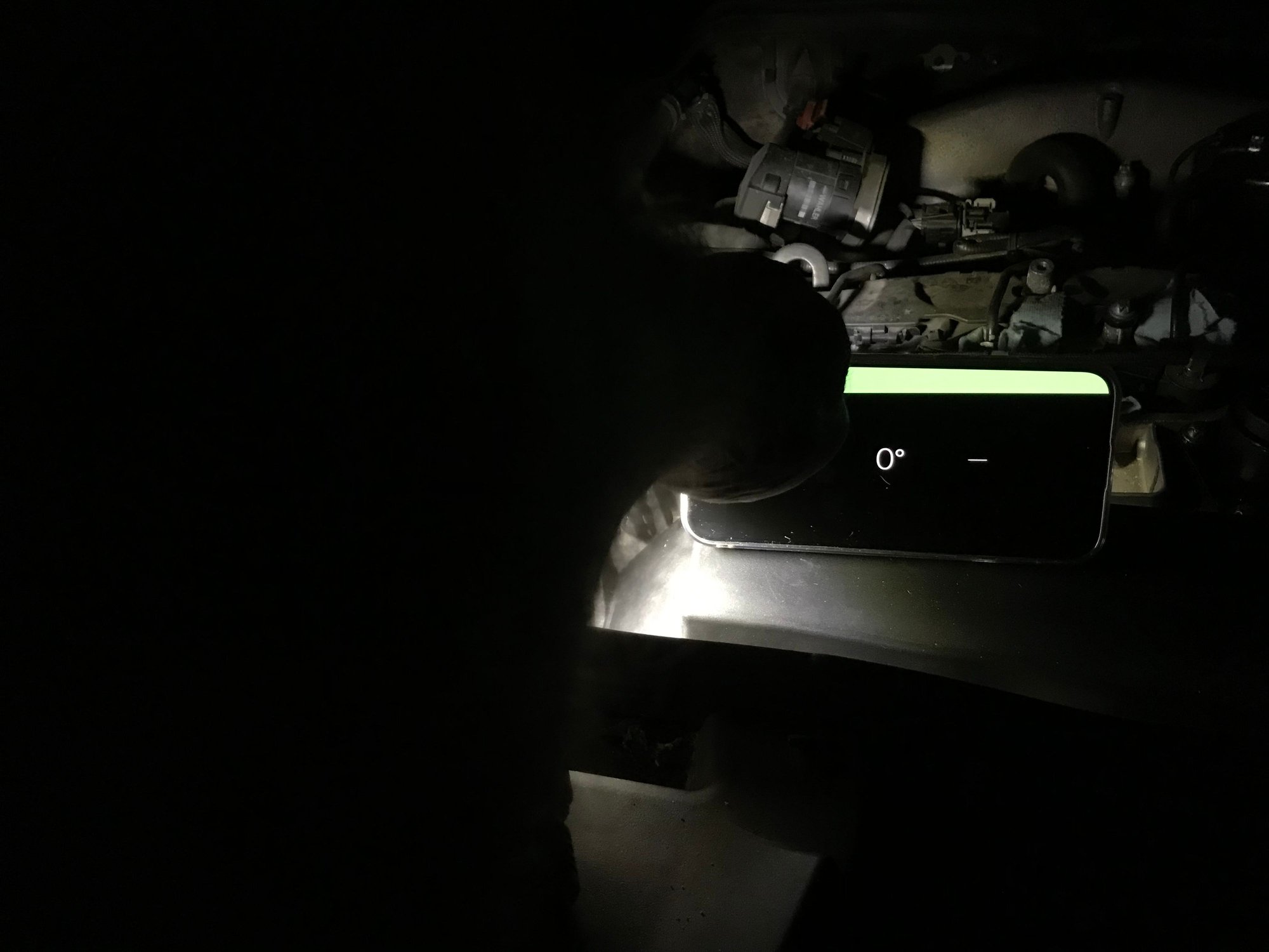

Although the vehicle looks level, using a iPhone 14 level app, at the rear of the filter air box, reads 0 degrees,

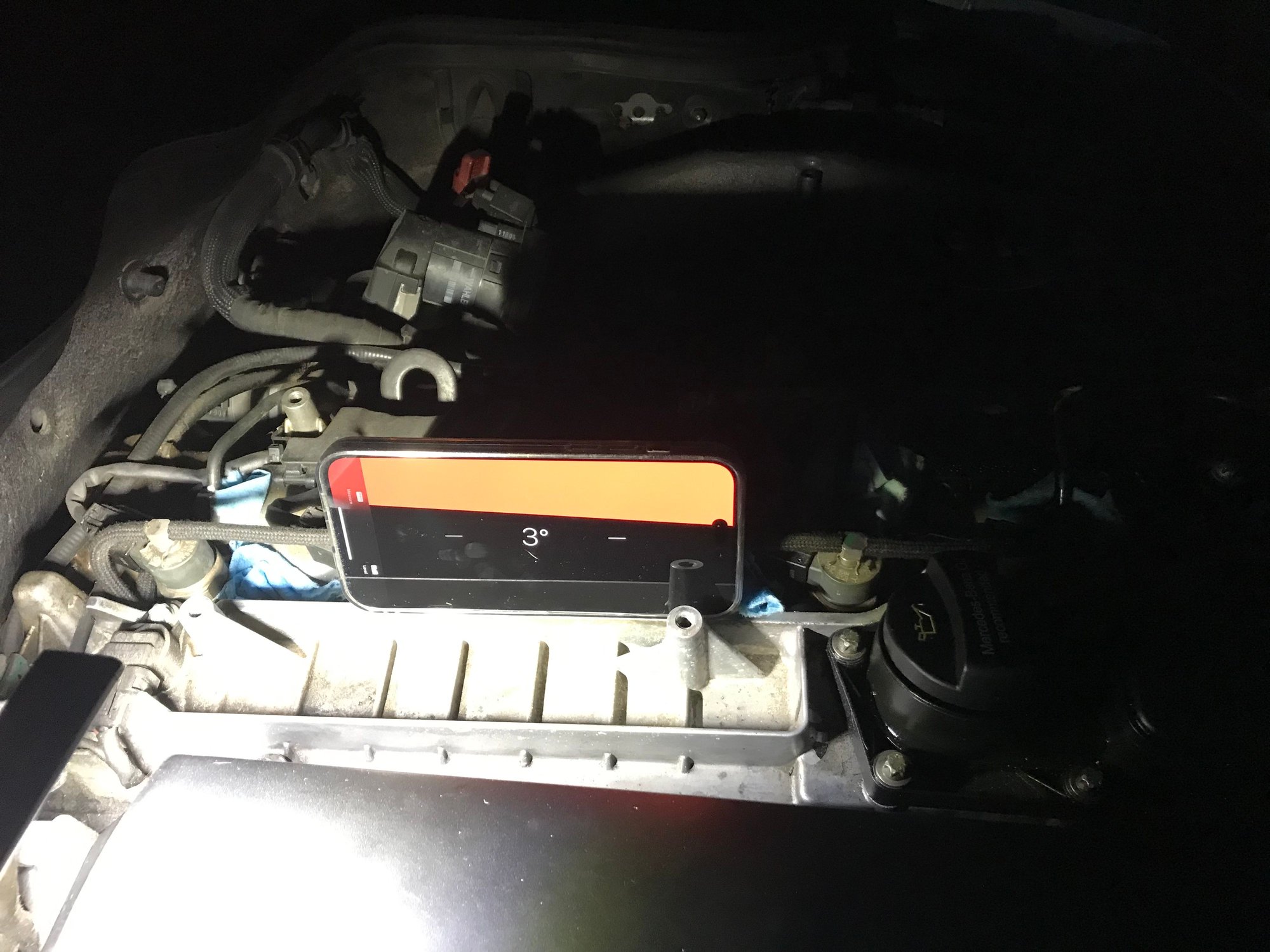

but the engine is canted higher at the front and the iPhone reads 3 degrees.
Is there any WIS information that differs ?
3 degrees on engine
0 degrees on air filter box
