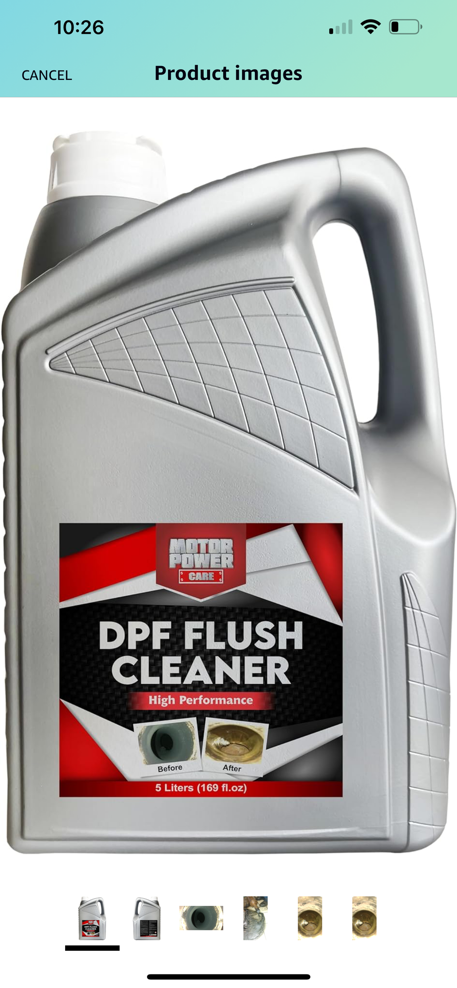

Has anyone cleaned there DPF recently? I was going to buy the Wynn dpf cleaner but it’s only available in Europe.
Has anyone taken off their dpf to soak it and clean it and if so what chemical solution or product did you use?
thoughts on this cleaner flush?

I just remove it and pressure wash it. No chemicals needed.

Is there a specific type of nozzle you used? Because I’ve heard pressure washing and damage it.
