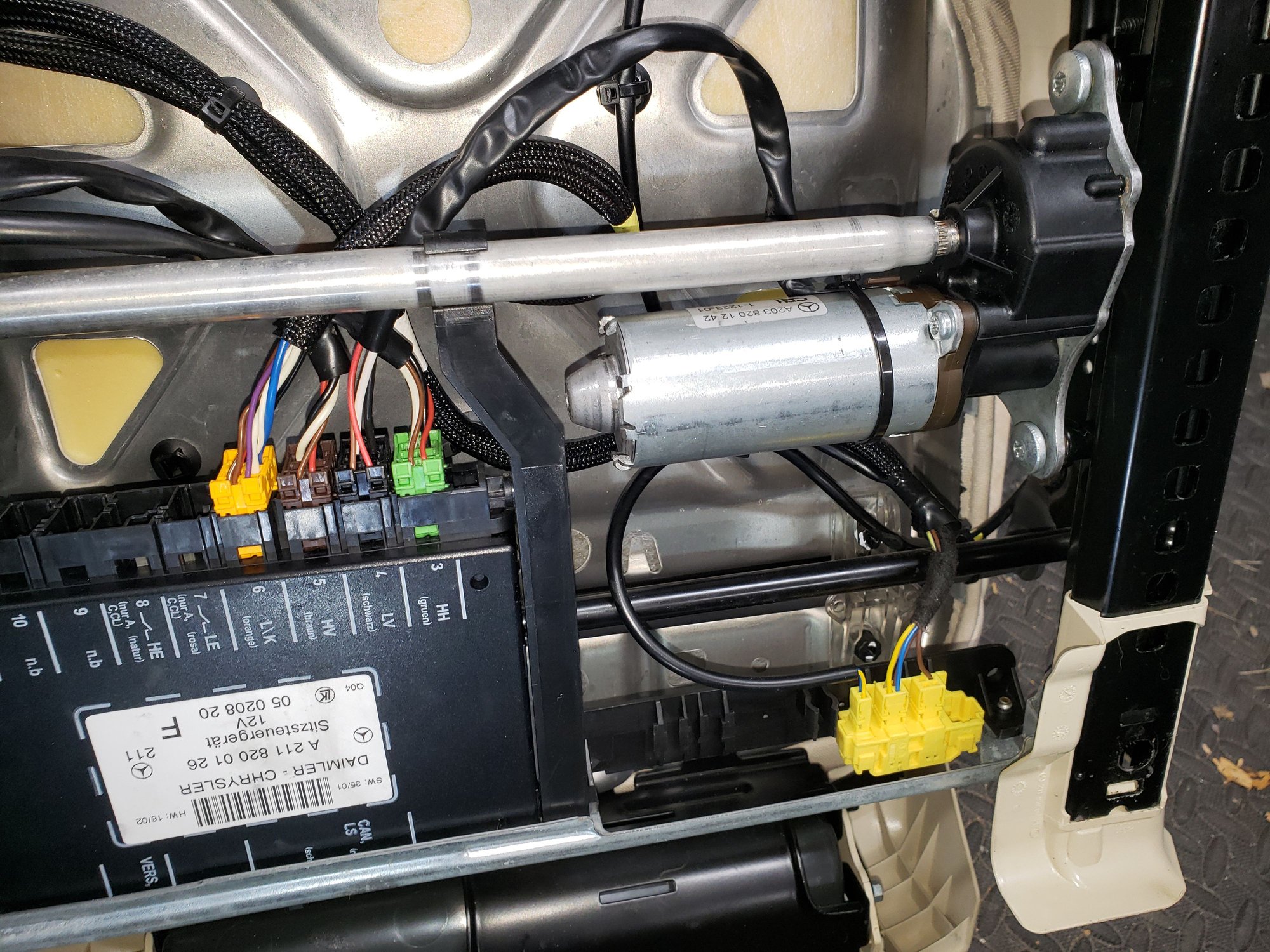

So back then, when dealing with the SRS codes (all fixed) I ran into a problem with the drivers seat. It got stuck. Deep in that post I discovered the seat would not go forward/back, banged the motor a couple of times with a mallet and got lucky and the seat forward/back motion was fixed. Yeah.
Forward to current, son tells me the drivers seat has been acting up lately - sort of sometimes wont go forward, won't go backwards. Sometimes will. He says it has been slowly getting worse, starting really showing up last winter and again this past fall of 2023 when it start getting cold.
I put it on the star and test the seat switches, they are all working correctly. But I can't reliably test the forward/backwards, get encoding error. Looks to be an issue with the encoder in the motor. Ok, very similar to what happen in that past post. So back then I avoided replacing that motor - but now I ordered a new one. Its a very simple replacement, just two screws hold it to the seat track bracket, it slides off, you slide the new one in and it comes with a new wire harness.
Put the seat back, 4 bolts torqued to 45NM, seatbelt bolt to 32NM. and your done.
Using the star go through the retraining on the forward/back range. And I have the same issue! Sometimes can move the seat forward/back, sometimes can't . Get the same encoder error on the star when it fails.
I rechecked the grounds, power - no issues. Its not the switches - they pass fine. That test also tests all the wiring to the seat controller for the switches. Its not the motor nor its wiring - it is brand new. Must be the seat controller!
Start searching - these are expensive new. But I see some sellers on ebay selling what are clearly gray-market versions. New units for less than ebay junk yard used units. For the first time, I decide to try one out. $85 free shipping from China, less then the $130+ for junkyard units, beats the $400+ for new units. So we order one. Maybe we will get lucky and it will work - if not. well - time to get a junkyard MB one.

I first thing I unbolt the seat, and remove that drivers seat controller and replace it with the Chinese clone one. Run all the star tests on that module - everything passes - seat is working perfectly. Ok, hook back up the amp meter inline with the battery and monitor what happens as the car goes to sleep. And sure enough - the 4A quickly drops to 2A in a few minutes, then drops to 1.5A in a few mins, then 1A, then 0.8A, then 0.5A, then 0.2A. Hangs there for about 45 mins, and then drops to 0.04A 40mA, the expected parasitic draw from a sleeping car.
So it was the failed seat controller. It was sort of working, enough for star to talk to it but it was somehow causing a high parasitic current draw - EDIT: quite possibly keeping the F-SAM awake., but it must have been failing to go to sleep among its other issues of unable to read the motor encoders for forward/back. So it was most likely chatting on the can buss - keeping all the other modules awake.
So replacing the seat motor was a waste of money. Oh well.
Summary - if you run into a 1.5A'ish parasitic draw - be thinking that something is keeping some module(s) awake. Oh and that super low cost Chinese seat controller clone - seems to work perfectly.

seat controller
I have fixed mine so I have a fairly good idea how it should look.... Can you post pictures of the internal so I can point at what the problems are!
Your next step will be to go inspect passenger seat controller.
BTW no need to remove seat... the plastic module case is just snapped in.
