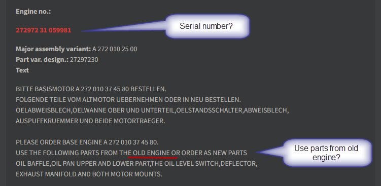

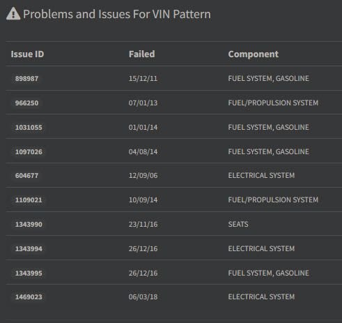

Other decoder questions, if anyone knows:
  1. What does "Problems and issues for VIN Pattern" mean? Are these repairs the car has had?
  2. If I wanted to double check the engine serial number - to be double sure I avoid the balance shaft sprocket issue what field should I look at?
  3. Why does it say, "USE THE FOLLOWING PARTS FROM THE OLD ENGINE OR ORDER AS NEW PARTS"?
Thanks!

The 17 inch wheels have the 45 series tires and the 18 have the 40. The ride will be softer just because of the 45 vs the 40. The default is luxury suspension. Lastvin.com and mb.vin are better vin decoders. Not sure what those other problems listed are actually referring to. I just ignore those, same with the use parts from old engine. Meaningless if you're not replacing the engine. If it says sports suspension then you probably have the lowered suspension.
The balance shaft sprocket issue only affected the 2006/2007 models so if you're looking at 2008/2009, you don't have to worry about it. The decoder also mentions the engine serial number and all the serial numbers in 2008/2009 are above the cut off point for the balance shaft issue. It was fixed in the early part of the 2007 model year so some 2007 are also fine.
