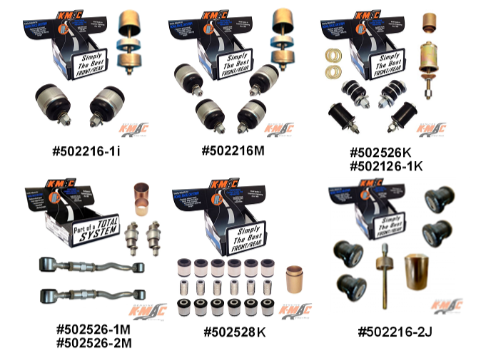

FOR THE W211 (ALL MODELS) WE MANUFACTURE A “TOTAL SYSTEM” !
Proudly having “IN-HOUSE” manufacture (not sourcing imports) allows us to have total control over quality and rapid, constant design upgrades, improvements.
Latest design breakthrough is both the Front (Camber and Caster) kits and the Rear (Camber & extra Toe) kits - No special tools or time consuming need for control arm removal to install.
SEE SPOILER - TOTAL SYSTEM
