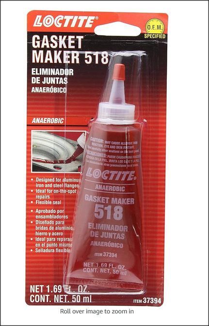

Here is a good paper gasket alternative that can also be used as a "gasket dressing".
But like all of them it needs some time to cure.
There may be others more suitable for oil pan gasket?
