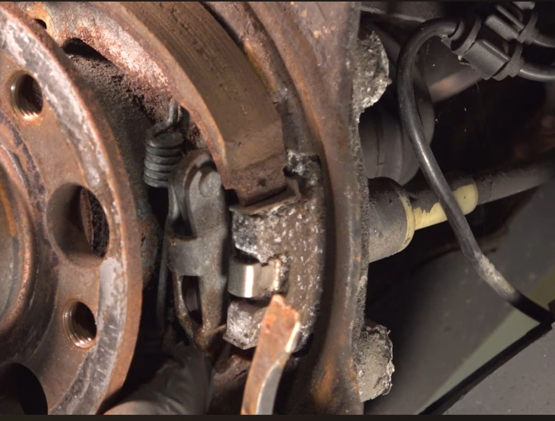

as add on, brake shoes are resting without tension from cable as in the picture. picture not from my project.
