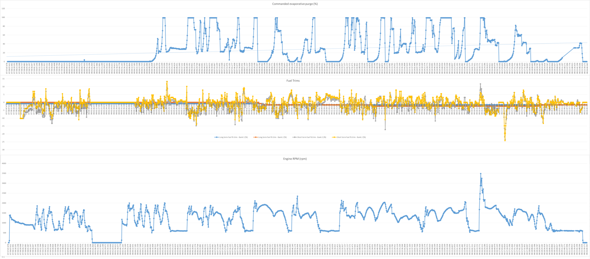

- I have also monitored other parameters and the EVAP values seem unusual. I am attaching an image with EVAP, Fuel trims and engine RPM. They are all from the same cycle, aligned. The car was stopped once from around 08:01 to 08:05 (flat zero line on the RPM chart).
- The chart seems to show that the EVAP is higly active, with a trend line from around 10% to 50% in just 20 minutes of driving.

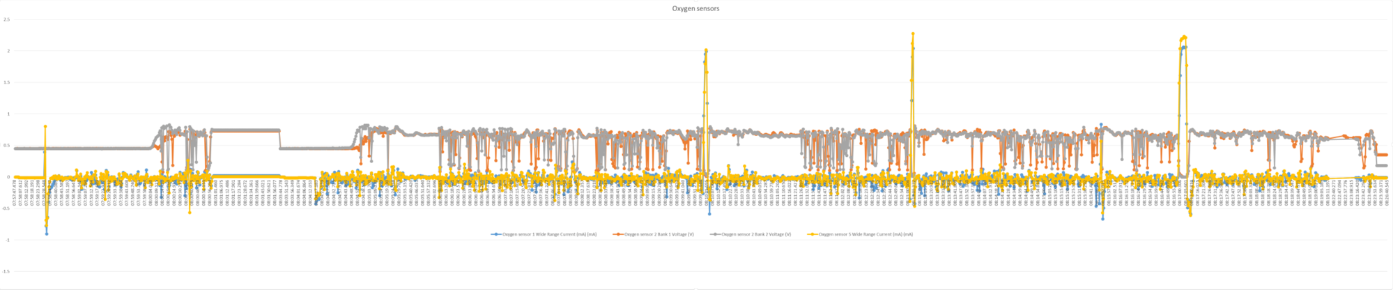

- I also attach oxygen sensor readings for reference.
