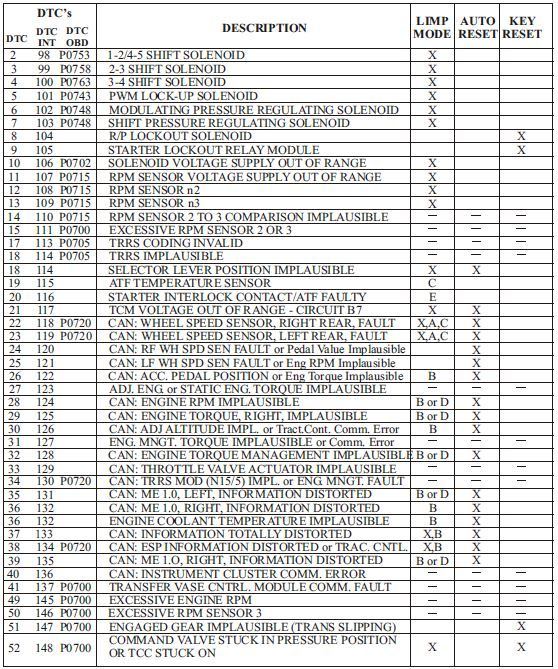

Rough rule of thumb, electrical faults in the 722.6xx transmission must be cleared with a MB-compatible scanner. Hydraulic/mechanical faults will clear with key off/on/off.
.pdf attachment shows location of modules on the W211. To access the TCM pull back the carpet on the passenger side where the passenger's feet rest. The modules are under the passenger's feet against the firewall, NOT the floor board! Pull back carpet, remove three each 10mm plastic nuts (one at top, two at bottom and one of those is a PITA to get to!). Tilt metal plate towards seat and the modules are all attached to the other side. You can then inspect TCM for fluid intrusion.
​​​​In my opinion (just opinion and where I would start), I would look at possibilities from most to least likely.
-Electronic Shifter Module on the transmission tunnel. If so, see this: https://mbworld.org/forums/w211-amg/...5-19-32-a.html
-Possible failing TCM.
-CANBUS issue involving the ESM and TCM.
The codes below point towards the Electronic Shift Module but I would confirm with a STAR/Xentry diagnostic tool or equivalent. If so, the detailed code should show up as a P1856, "Selection position lever detection has failed". Note that there are four each sub-codes that fall under the P0705. The DTC 18 matches the symptoms on your car. If it is the lever selector module, replacement will take you 3-5 hours and a rebuilt sensor module is available for under $150. It will not need to be coded to the car.
