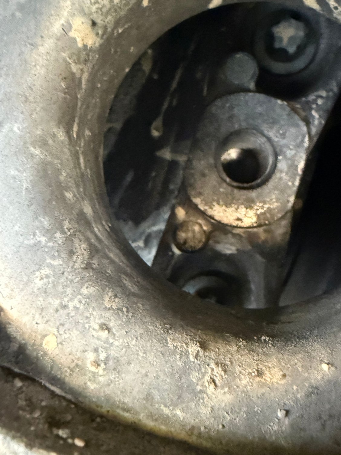

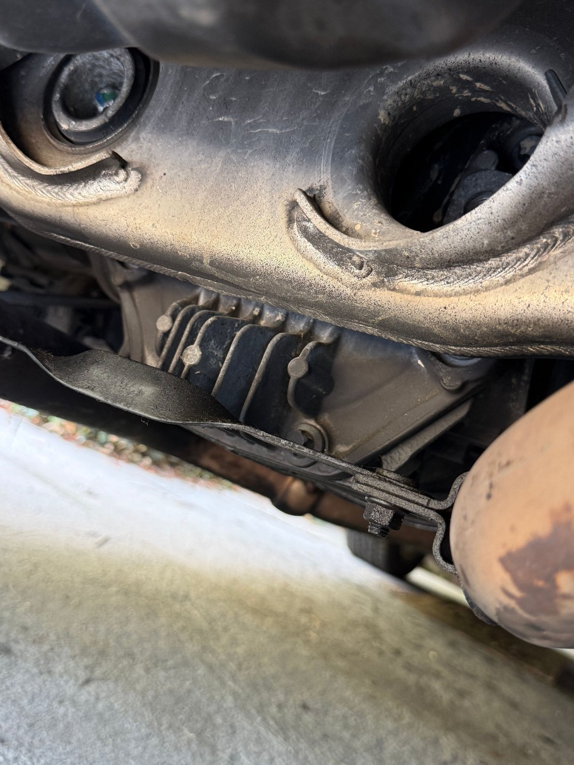

Left assembly is fasted to differential. No assembly on right. What component is this?
Clean threads in differential.
Clean threads in differential. - While investigating a squeak from the rear of the car, I discovered an assembly missing. It screws into the side of differential. There’s no noticeable difference with the car handling. What’s missing?

I was looking for subframe bushings, and there were also diff bushing. I noticed that there was mentioned that only one is used even though there's provison for two. So you should be good.
Thank you. This makes my day! Only one differential bushing is used.
