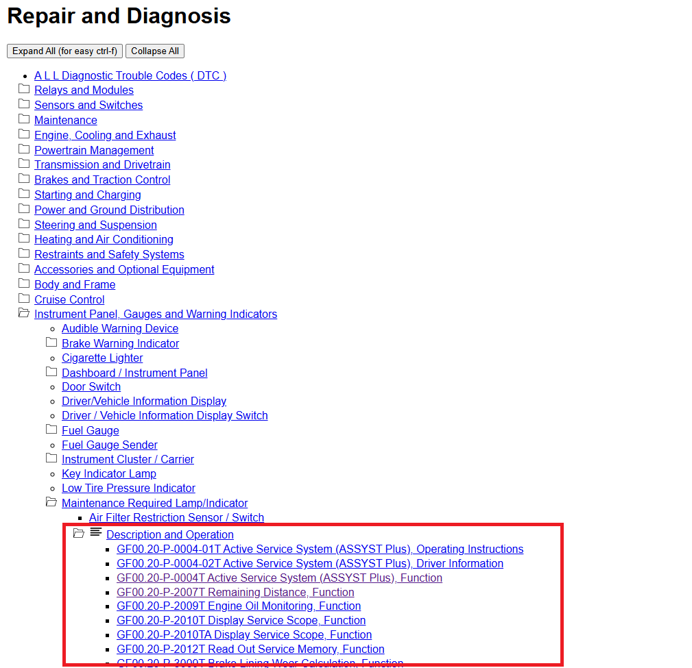

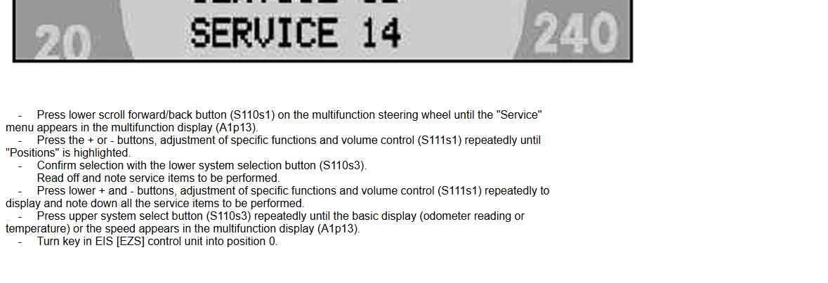

I just commented in a thread about the ASSYST PLUS menu. Can read it here: https://mbworld.org/forums/e-class-w...-download.html

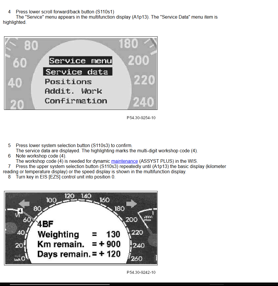

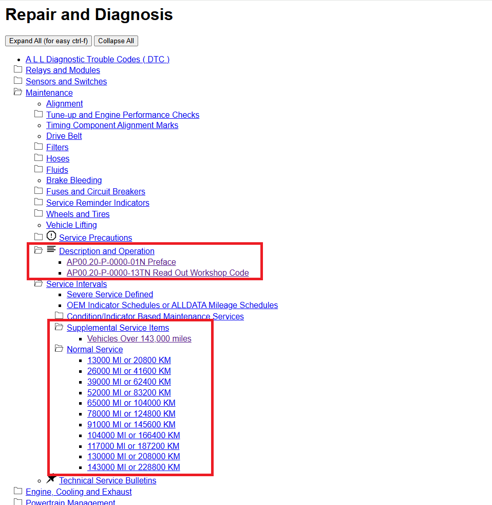

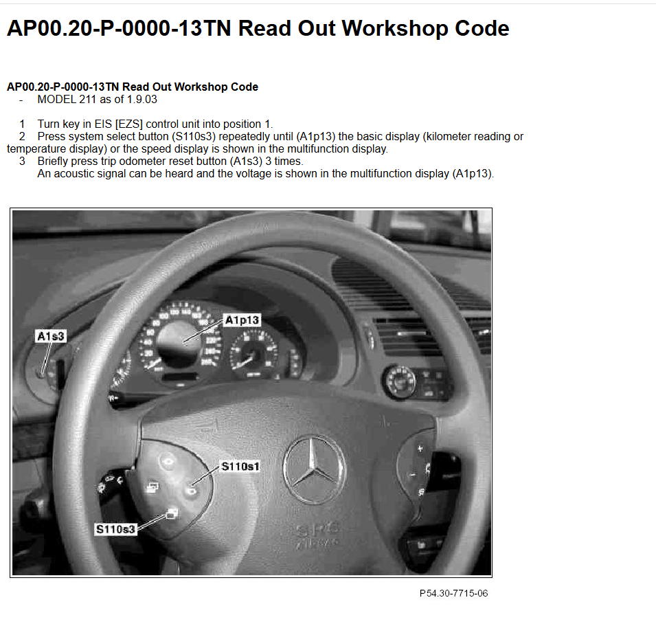

Then heres a link to the manual where I found alot of info on the service reminder. Theres alot of info on it. Here: https://charm.li/Mercedes%20Benz/200...d%20Diagnosis/
I'll post a few things you may want to look thru.
Heres where i found the above info:

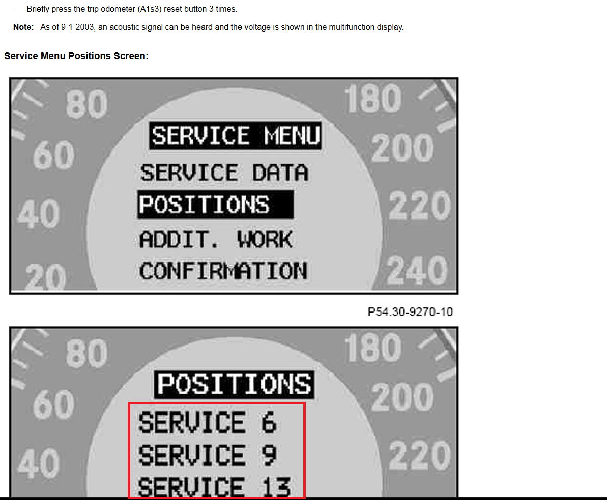

If you are in the menus go to the Positions tab and it will show the services by #, then compare what is in the manual for that service.

Bizarre! That kind of worked.
I followed the first set of instructions past the point where the voltage is displayed and then got a message saying service in 26 days. Then by doing one of the buttons S110S3 or similar, I got to a reset menu and reqested a full reset confirmation. I did this and now it says I have 13000 miles and 365 days to next service.

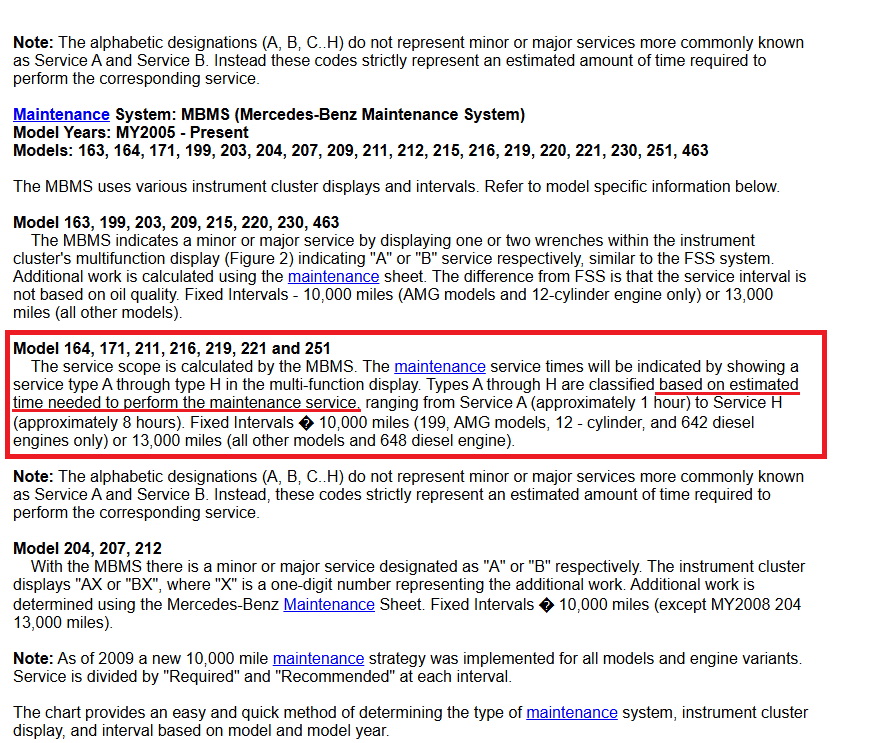

According to the manual in a W211 the "D" represents the amount of time it should take to service the car for that upcoming service.
