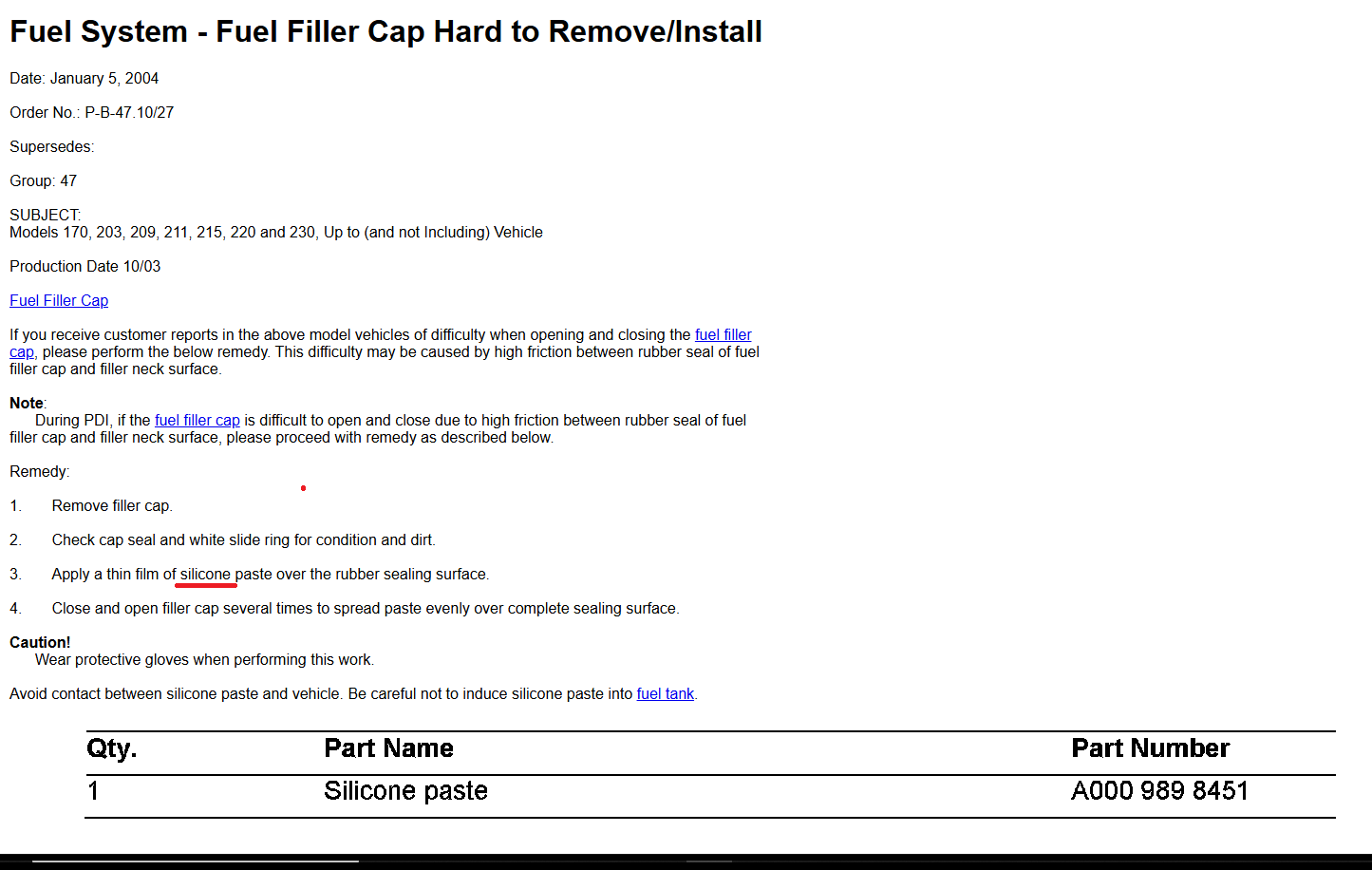

Not sure id use wd-40 on the gas cap since i think it may interact negatively with the rubber seal. In the manual there is a note about using a silicone paste on the cap.

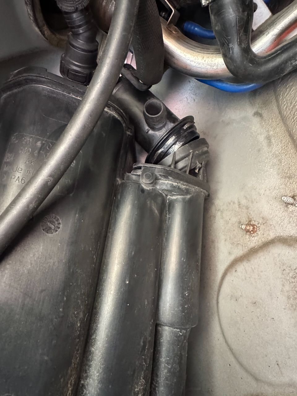

I decided to take a look at the work done by supposed experts, before delving into other parts of the system to find my P0455 large EVP leak error. See below - The shut off valve was completely detached! Looks like they installed it without the O-ring....and vibration caused it to come loose...so no wonder I still have a "large leak". The unfortunate consequence of the valve being detached is that it was hard for me to get gas in the tank....clearly because the tank couldn't vent without the valve attached....so the charcoal canister filled with gas and is now clogged. So although the shop refunded my money, their crappy work has now ruined my canister...and these canisters are made of unobtanium. Luckily, I had bought a used canister a few months ago, and installed it today with a new valve.
Now...for the first time in a year I am getting a different code. Until now I was getting P0455 (large leak)...NOW I am getting P0446 (EVAP Vent control circuit). I regard this as good news and next I will check and clean the electrical connections on the shut-off valve. Then test. After that I will work on replacing the Purge valve. After that I may replace the Tank pressure sensor. After that it's hoses. One step at a time... If anyone has a moment of brilliance to share please do so. (and thanks to all for the contributions so far...)

This is how the
This is how the "professional" State certified emissions shop left my shut off valve

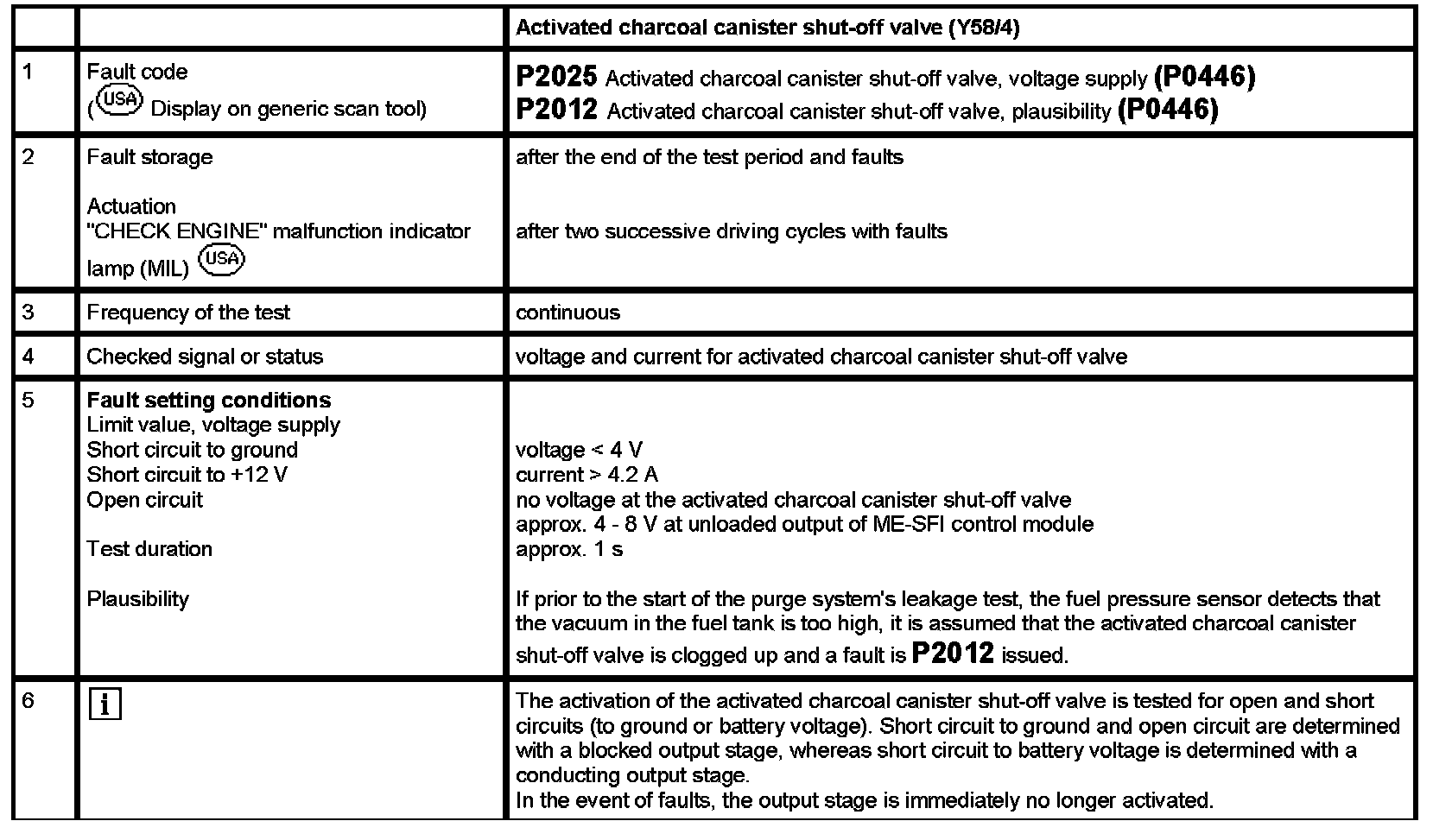

If im reading the info below right it may point to a voltage issue. With your scanner can you function test the canister shutoff valve, test the connector for voltage and ground.
