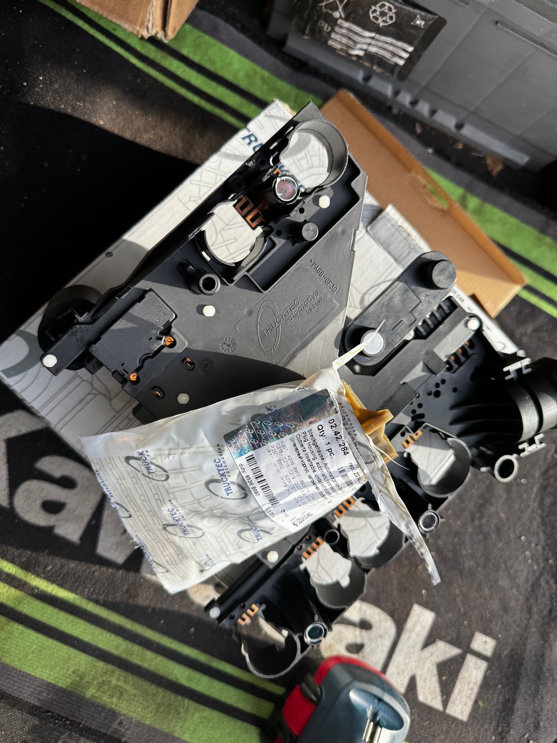

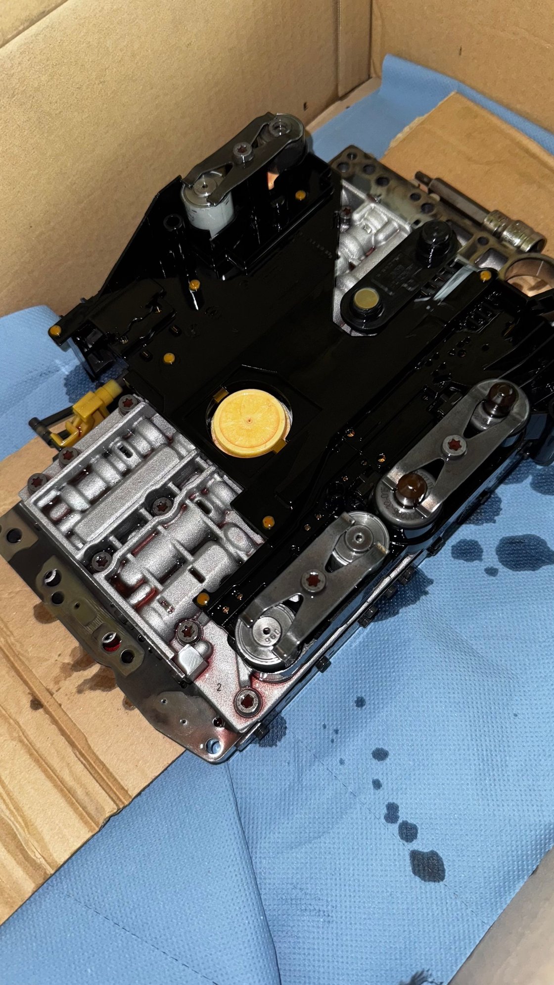

I heard changing to the newer A2402701700 solves the problem.
So I did, removed, cleaned everything. Rebuilt and replaced everything, checked 90 degrees with a dipstick. No success.
I got no codes whatsoever, I deactivated the A2402701700 part with my Xentry, and the problem doesn’t reappear. Until I shut down the car and start it, it fully resets it back to like before.
On colder earlier days it’s even worse.
I start the car wait 1 minute and drive off and I get this insane jolt forwards like someone just rammed me from behind.
When I wait like 2 minutes it’s waaaaay smoother, the more I wait the better it gets. But that is not a solution and fix.
When I press the Pedal harder from a red light than usual, the problem is non existent. But I can’t push the car when it’s still cold and not lubed with oil on the inside.
I can’t be the only one suffering from this problem.
I even had a flush and everything. No success.
The one thing I know that my, oil shaft seal, rotary shaft seal or whatever you call it is not sealed right since I lose oil (not much).
maybe a transmission reset?
I’m out of ideas. Need help.

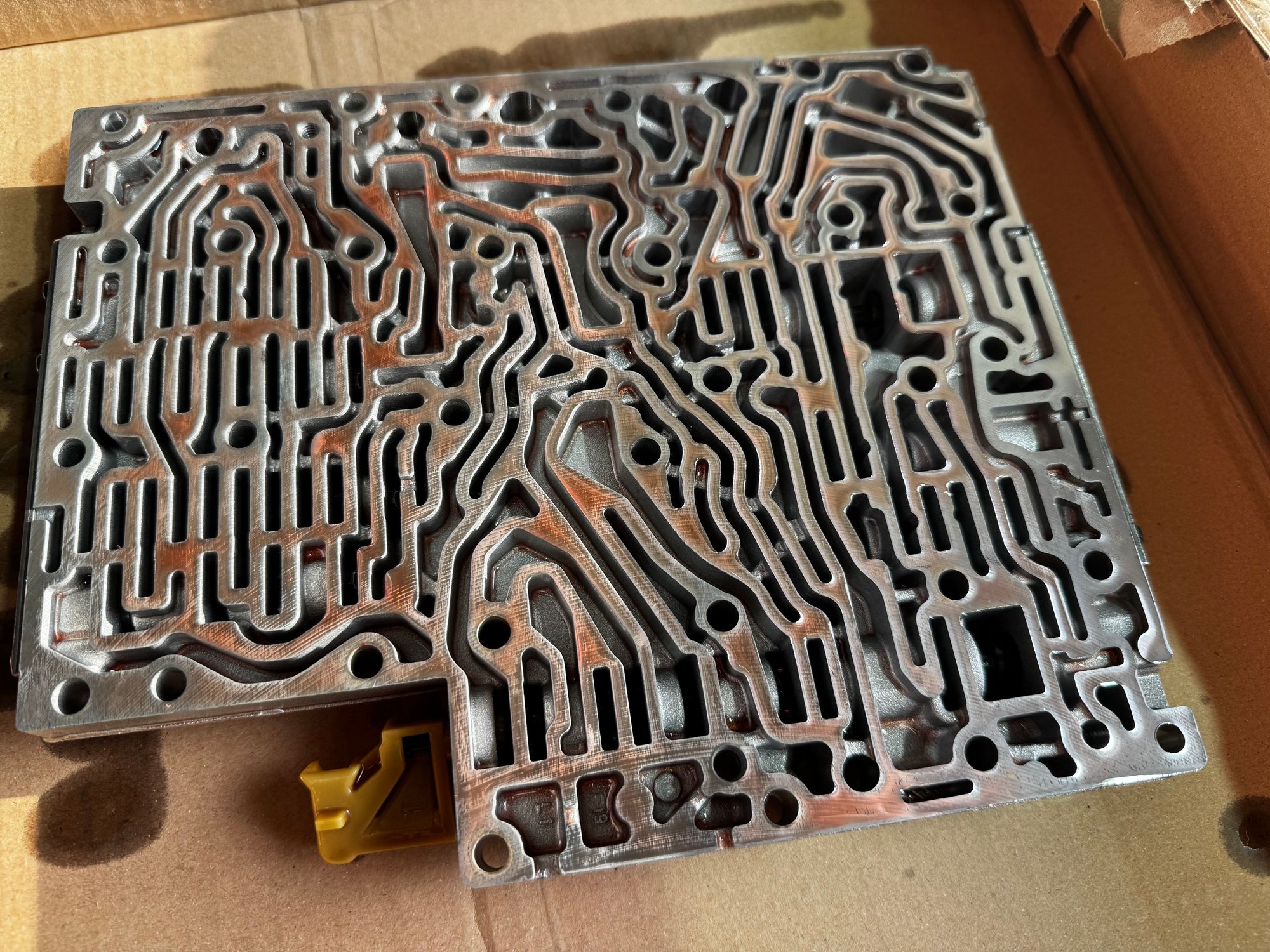

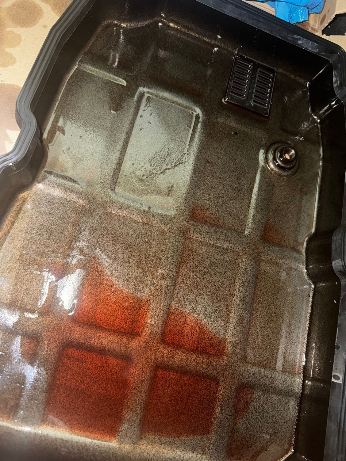

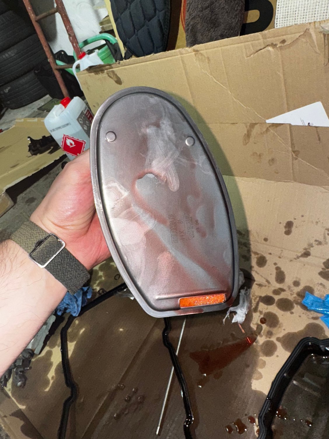

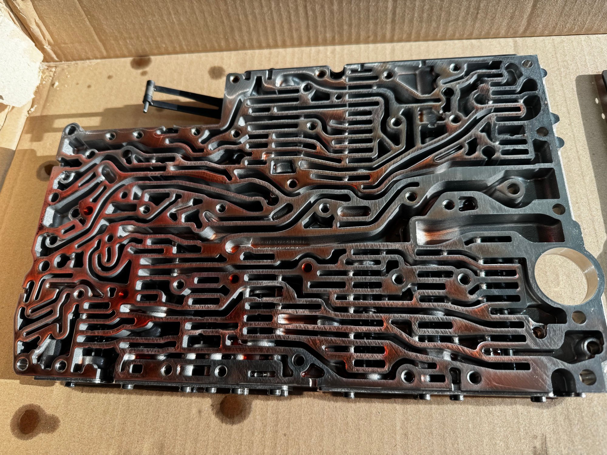

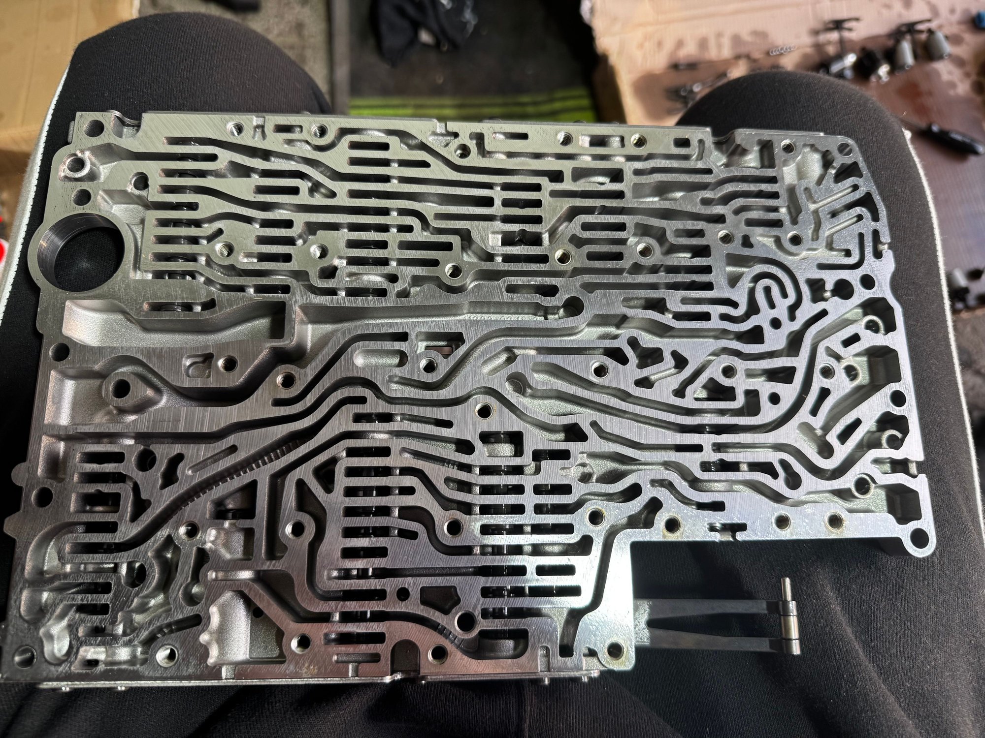

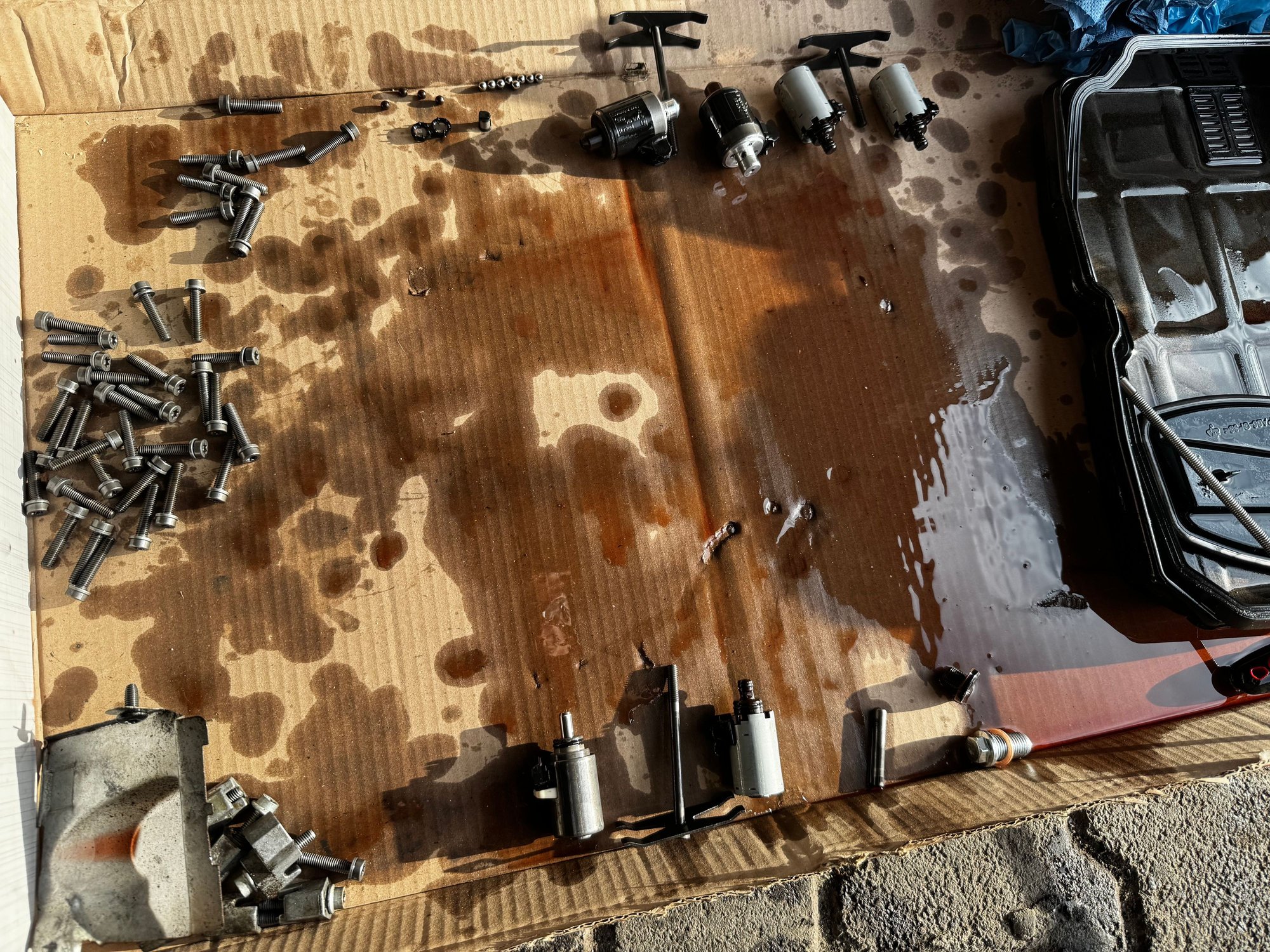

Took out everything
Took out everything
Cleaned as much as possible
Absolutely clean
Absolutely clean
Clean no residue.
Clean no residue.
