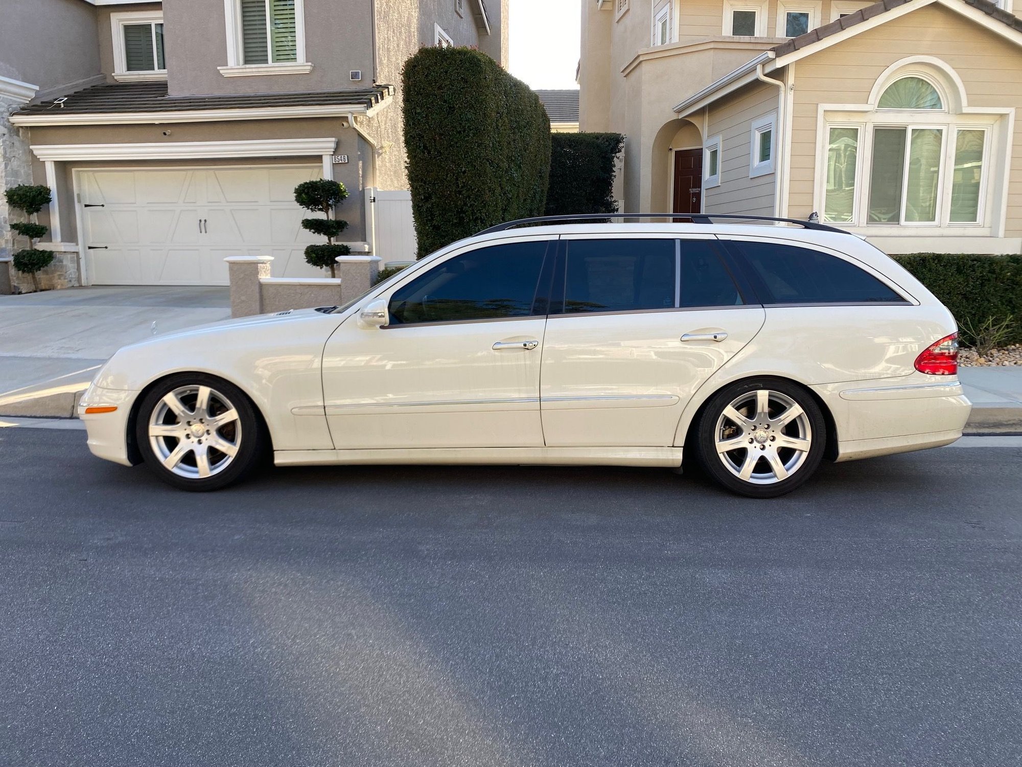

i chose to convert the rear self leveling airbags to accept conventional springs before even attempting to lower. i could have used lowering links there but i wanted a stiffer ride quality. i harvested some sedan rear lower control arms from my local junk yard and while i was there i took the springs as well. the donor vehicle had sport suspension. i opted to install everything on the wagon just to gain experience plus one of the bags was leaking overnight. after a few weeks of driving with a carolina squat (rear was much lower than the front), it was time to dive into lowering.

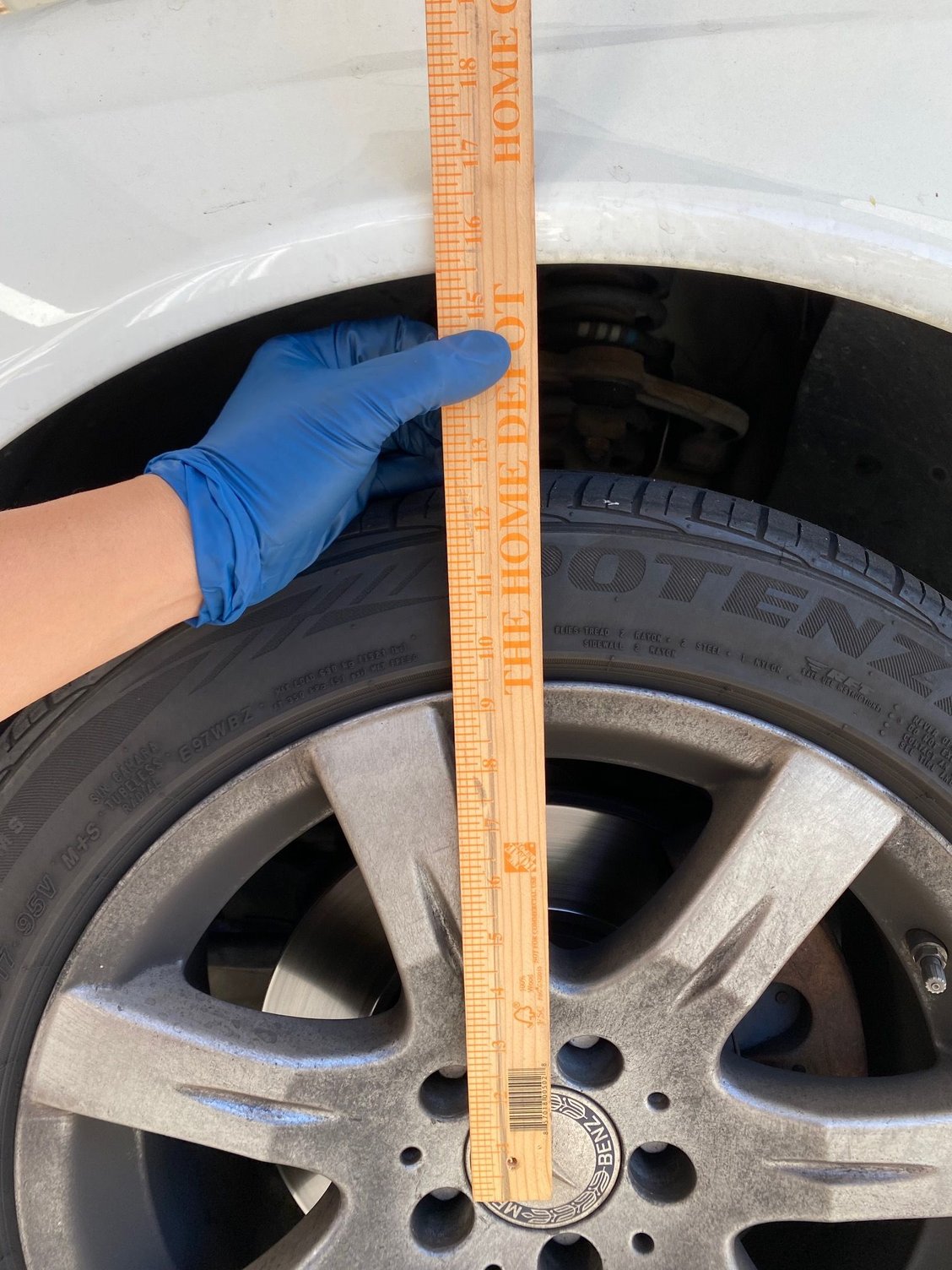

front initial measurement

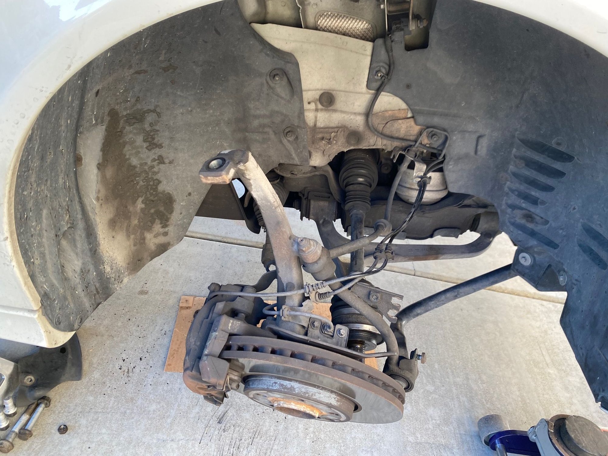

searching youtube and online showed different ways to remove the front strut assemblies. i opted to disconnect the upper ball joint. i found out that you need to remove the axle from the hubs to give more room as well. the upper a-arm needs to be loosened to be able to pry upwards to give more clearance to remove. it's hard to see in the picture but the sway bar lower endlink was disconnected as well.

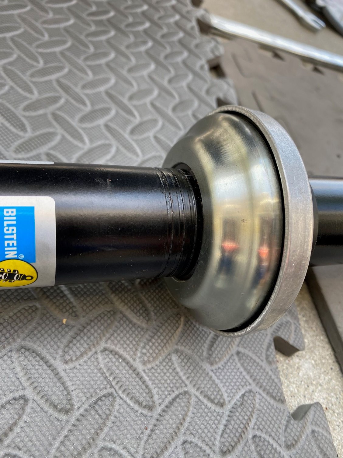

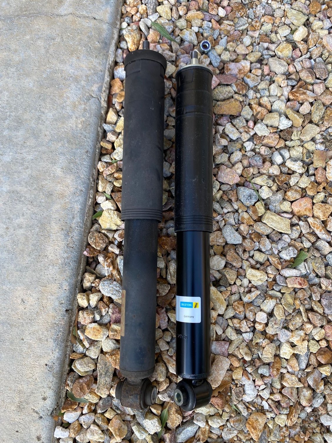

comparison of the rear OEM non-sport vs bilstein shocks which interestingly is shorter (p/n 2113264100)! not sure if i bought the wrong ones.

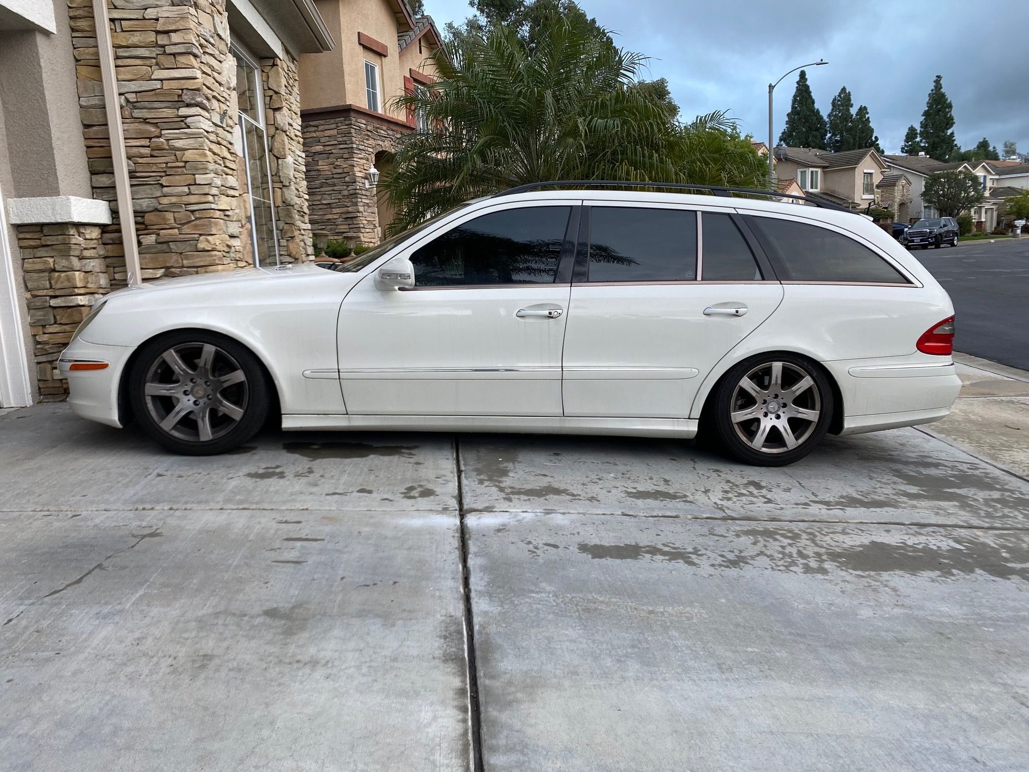

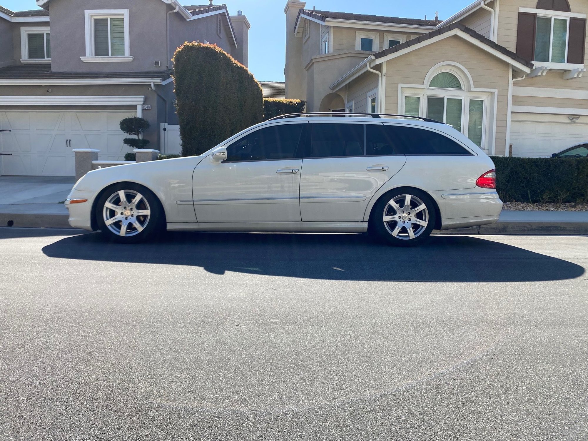

post install, i was not expecting the car to be this low! granted my driveway is slopped so the rear is slightly exaggerated too.

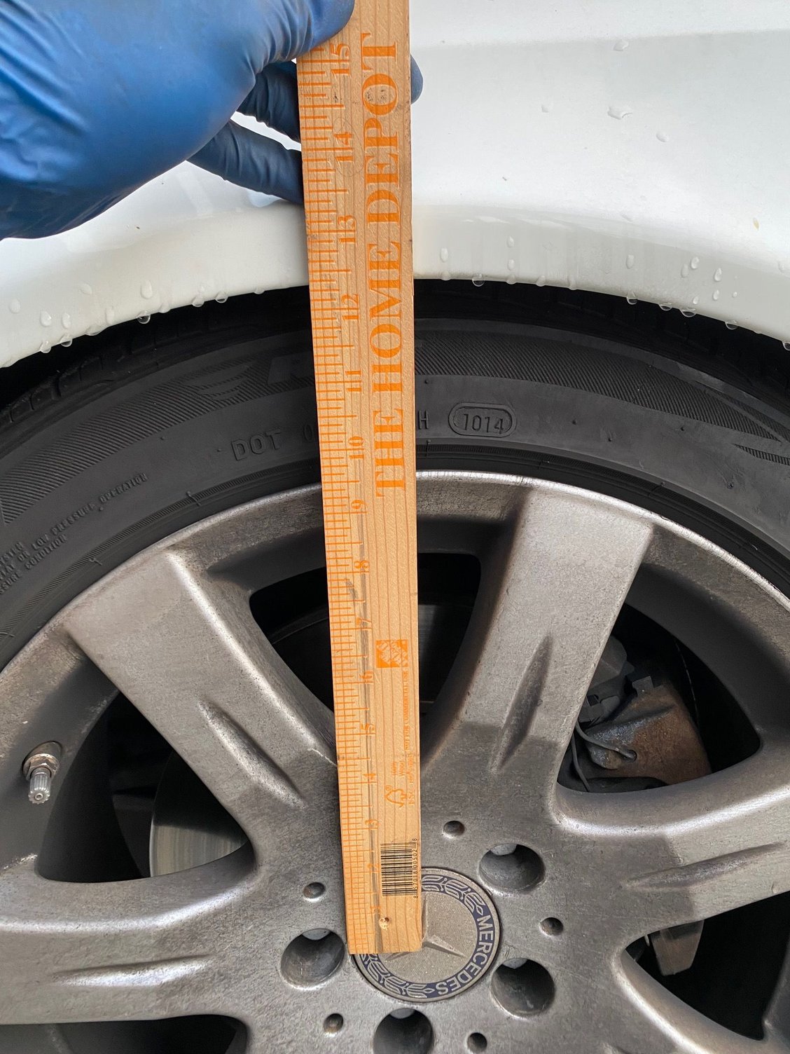

front final measurement revealed a drop total of 3.25”.
first drive impressions were uneventful. car was much more compliant and solid but i immediately noticed the car would hit the front bump stops often…yeah too low! i will have to live with this for now since i was physically beat from the install. it's times like these i wish i had a personal lift. more to come!

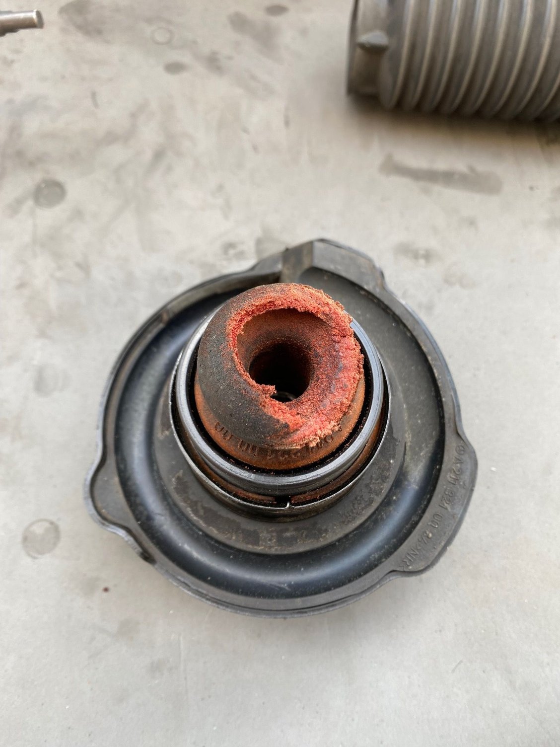

as suspected, i found the bump stops to be disintegrated! sadly i was unable to replace them so i ran them as is.

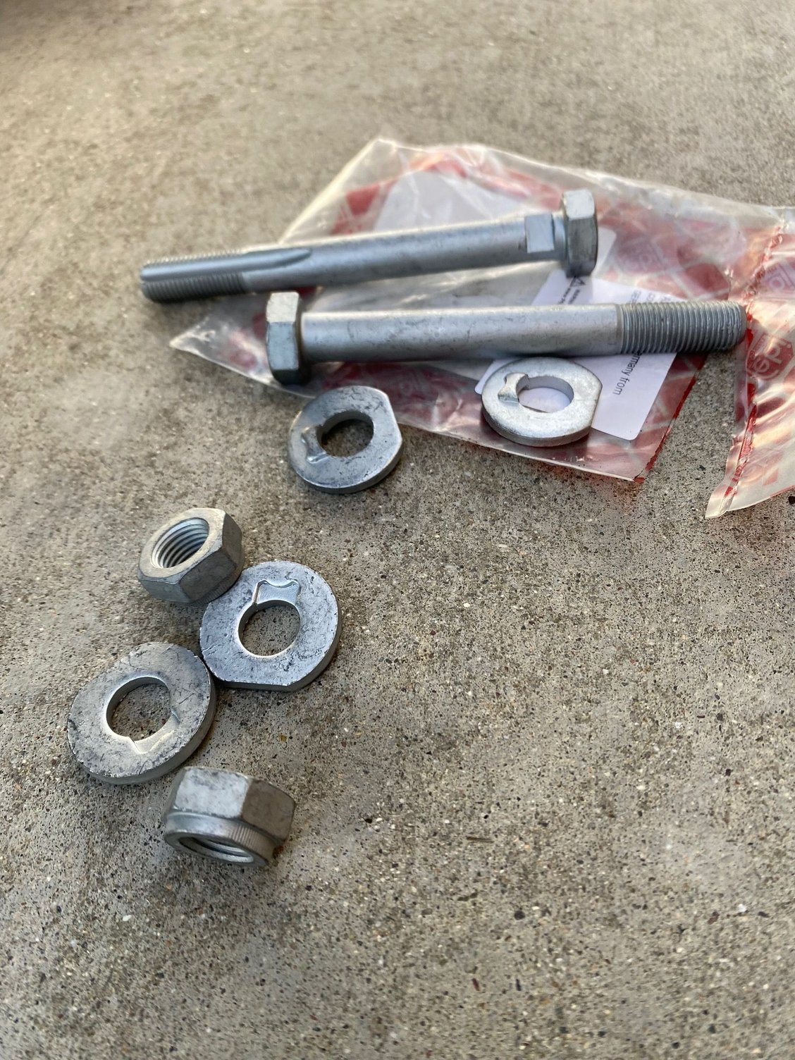

i also sourced some camber correction bolts for a 4matic (febi bilstein 220 990 00 99) and installed them. NOTE: the very front nut was almost impossible to tighten w/o removing the front sway bar, which you cannot do w/o dropping the subframe. opted to simply tighten things 1mm at a time (as much granularity as my 22mm ratcheting box wrench could do). you cannot turn the bolt as it needs to remain stationary for camber correction.

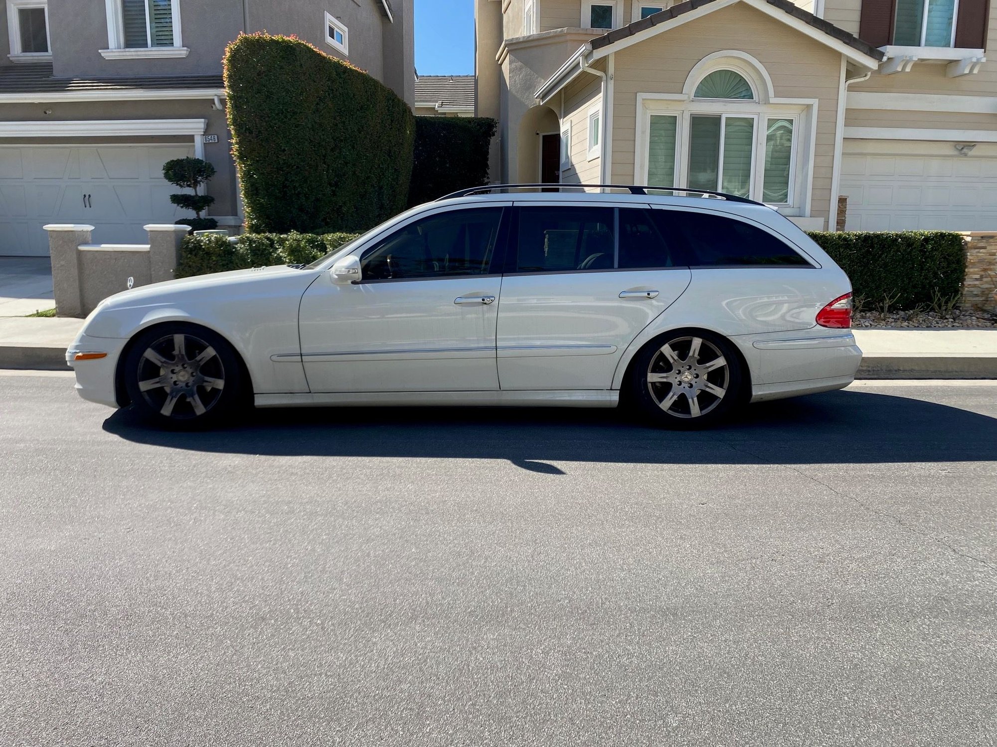

final stance, though subtle in being raised, is much MUCH better! i believe adjusting the c-clips up front on the shocks added more spring preload which equals a slightly more floaty ride (not like stock however), a small gain in height, with minimal bump stop strikes.
a wheel alignment still shows ~2deg of negative camber up front despite the camber correction bolts, and almost 3deg neg out back. i suppose this is next on the list.
