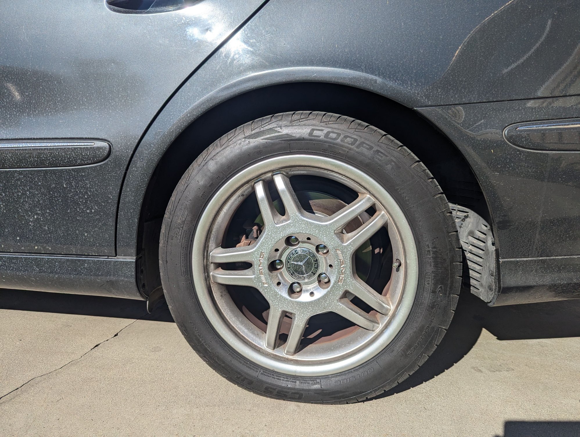

After 6 years of ownership my rear airbags finally started sagging over night. Against my better judgement I decided to try Arnott replacement air springs. 3 weeks later both Arnott air springs exploded on the freeway a few minutes apart. The second one exploded while the car was parked waiting for the tow truck.
After that experience I decided to go back to my original plan. I picked up a set of used 2006 E350 sedan (non sport) rear springs, spring spacers and lower control arms. $130 all in.
The spring spacers they came with (2113250584) are the thickest stock size with 4 disks in the middle. MB offers version of the spacer from 0-4 disks in the middle to adjust ride height.
The installation was relatively easy but the ride height was a bit too low. The springs were designed for the sedan which is lighter than the wagon so I ordered an additional spring spacer from the dealer and disassembled it into its individual components.
Split the spacer disks in half and added 2 disks to each side for a total of 6 per side.
Perfection
The ride quality with the coil springs is sublime, much better than the air springs. I should have done the coil spring conversion years ago just for the improved ride. Arnott air springs are garbage.
