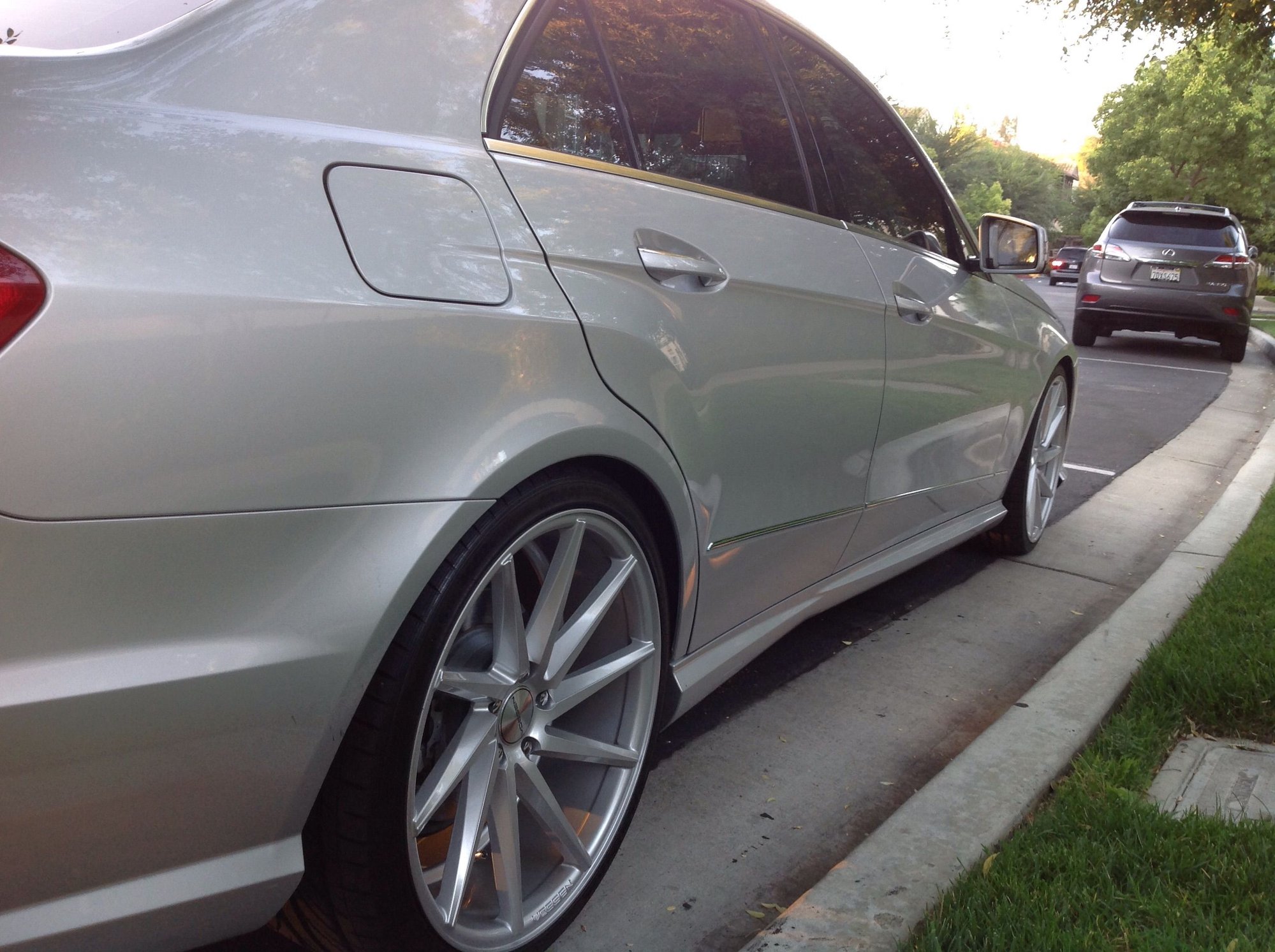

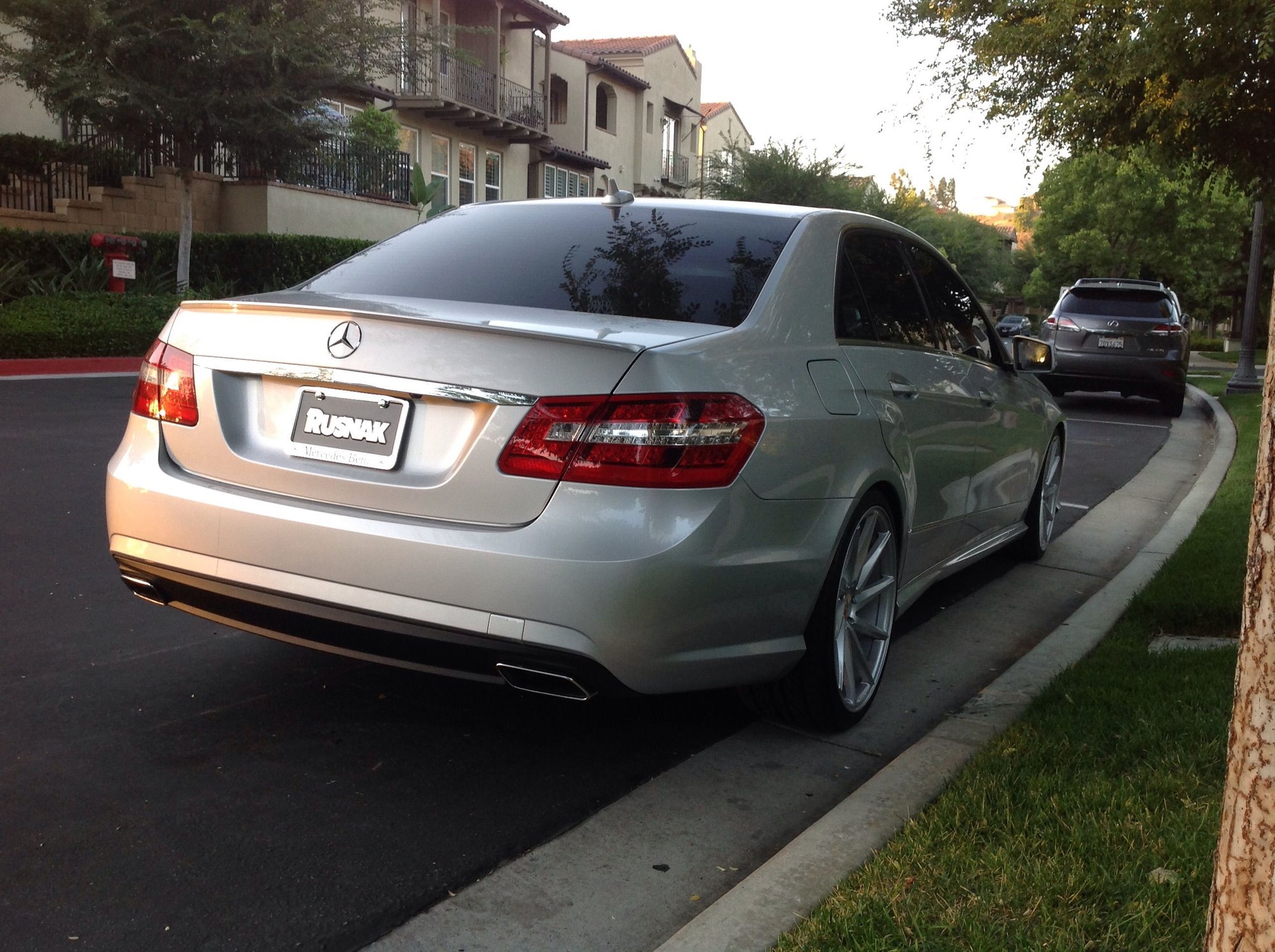

Hi Ghostrider. I own a 2011 Mercedes E350 ( W212 ) Sedan lower on H&R Sport Spings and 20" Vossen CTX wheels. If these will offset my car, please PM me MBfourm member pricing. I went thought a pair rear Hankook V12 in 6 months and less than 12,000 miles.
Here is a photo of my car for reference:
