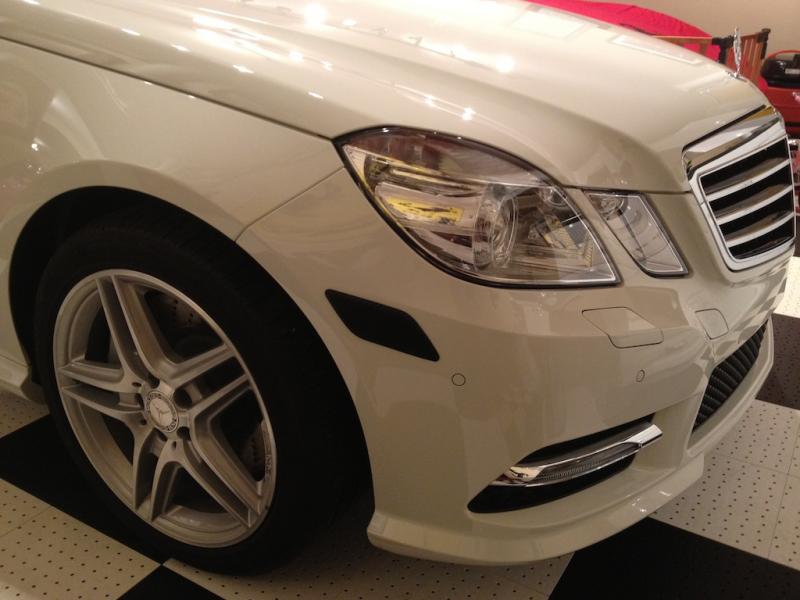

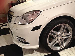

I used 3m DiNoc carbon fiber and wrapped my side markers today. It looks awesome. When the light is on, you can see the cf weave in the light. I did it myself with no prior experience. It was a fun project that only took a part of the afternoon.

got any pics of it lit up?

Check again. It didnt upload the first time. Sorry.

looks nice!

looks cool ! i think they'll look even better if you change the amber bulbs to led but it's illegal in most states .

No. Thats about it. But I would not want to touch a razor blade to my car. So I took a picture of the side marker and outlined it in a program like MS PAINT. Then I printed that outline so it was the exact shape of the marker. I made it about 1% bigger than the marker. That was my template. Then I cut the film and with the hair dryer and a credit card (actually my health insurance card b/c it is thinner), I was able to curl the edges around the marker (Between the paint and marker)

Looks good! I considered it on mine but the guys who did it convinced me to get Gloss Black to cover those eye sores, which I agree as I had no CF on the car.... Buuuut now, with my CF B-Pillars....
I dig 'em. I'm surprised the light shines through as they don't shine through my 3M Gloss Black material at all.... but it's better for you in a legality sense. Also, I dig the pattern being shown.
