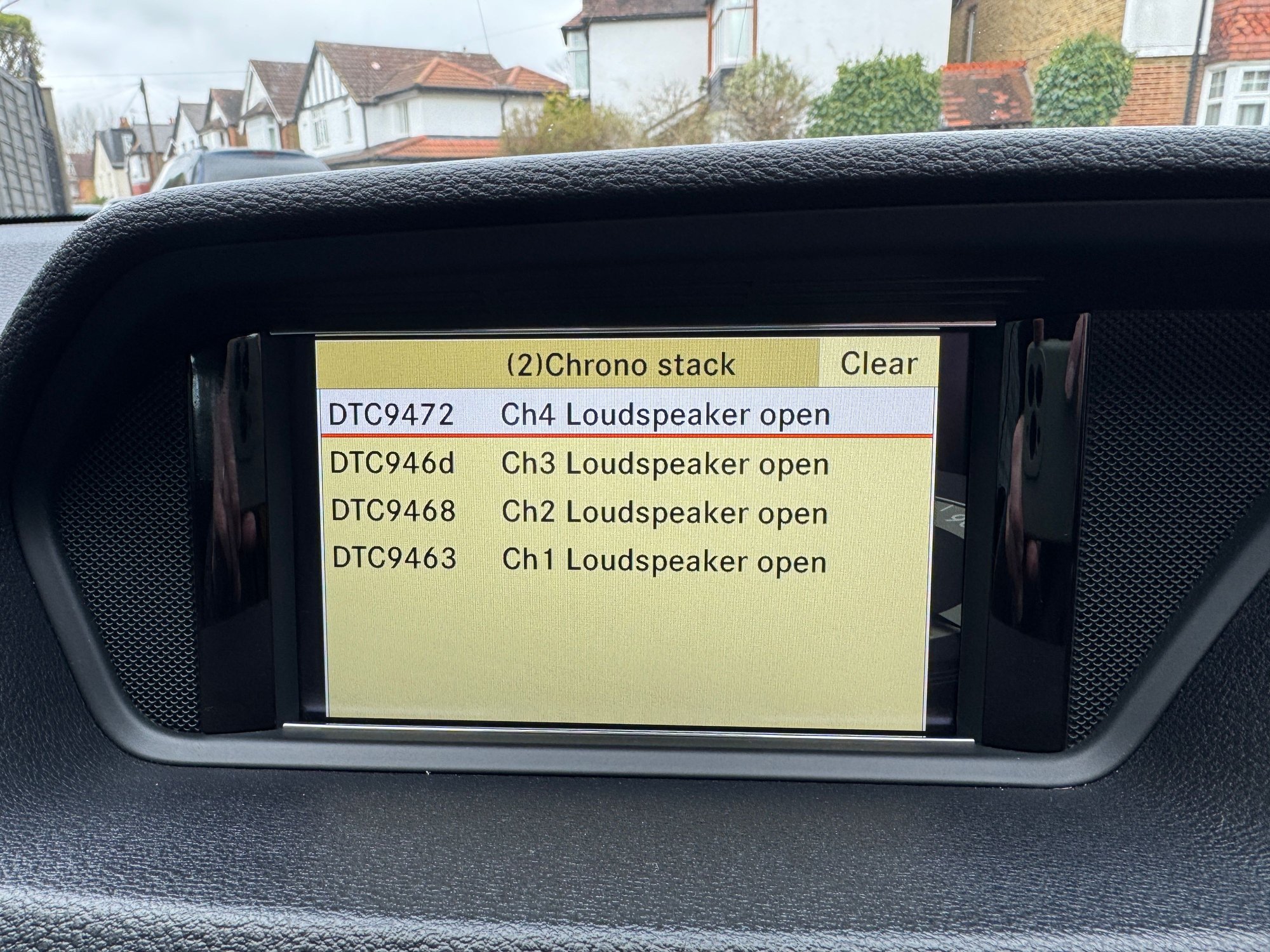

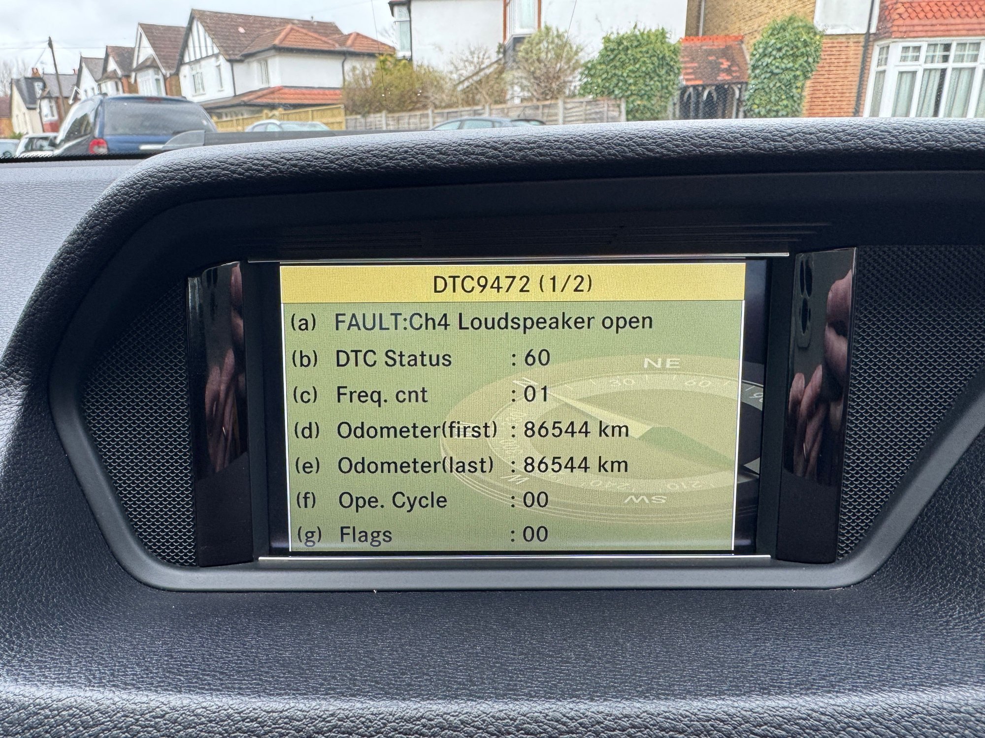

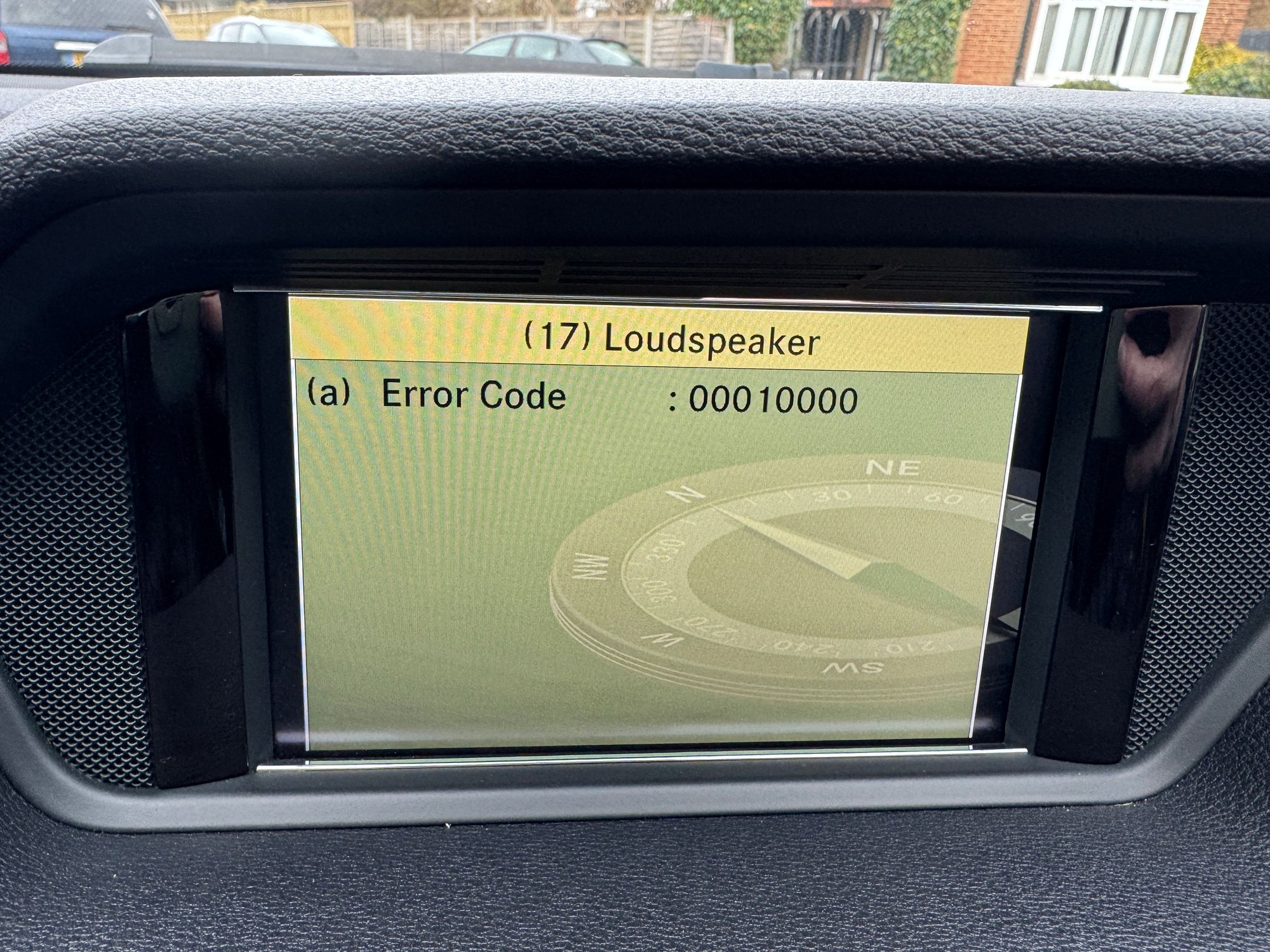

On this topic, I had the same issue as well, on a 2014 SLK while I was doing my backup camera combo install. I may've made a mistake and changed Aux to ON prematurely, as I did not yet have the AUX cable plugged in. Sound was fine on the head unit when in the factory audio sources, like FM, then I shut it down and go to sleep and the next day all regular audio from the head unit is gone. Also, I run the circuit test and it says Loudspeaker NG. Ugh.

To fix this, I went into engineering mode, go to 7. HW settings, choose 7.5 TGW Parameter, (2) Audio source, and set it to external amplifier. Then, without exiting Engineering mode at all or making any other change, I shut off the car, locked it, and let it go to sleep mode (which evidently it does if it's left locked for at least 10 minutes.) The sites I found about this source are not at all clear as to when internal amplifier versus external amplifier is appropriate, but all I know is it made the sound come back, and it's been back for days. I have no idea if my car is optioned in some way having to do with the amplifier, but I'm pretty confident there's no aftermarket amplifier, so this made it work BEFORE I completed the new backup system audio portion.

Thank you so much! I had exactly the same errors and no audio. I tried the switch to the external amp and locked up the car for 10 mins and audio just came back !! Thanks again!!
