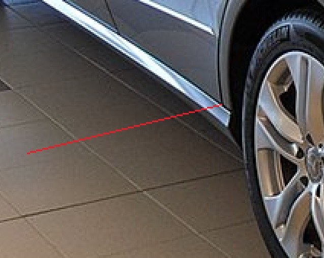

Hi,
I just went to a dealer to check out a W212 E250 CDI here in sweden with quite a few km on it 127000km / 78 914 miles and it was really nice in total.
However one thing really bothered me, on the back fenders (?) where the bottom front part of the rear fender meets the side spoiler just there was rust on both left and rear fenders and the paint was cracked around it.
The exact same condition on both sides, that was the really strange thing, if it would be on one side only i could imagine it was caused from something hitting this corner.
Do anyone know or have a clue what could have caused this..
Do you imagine this would be a warranty issue for MB?
Should i walk away from a car with these conditions?

It appears to be at a MB dealer. Why don't you ask them about the warranty issue?
As a general rule, modern higher end cars don't rust anymore. One can't tell anything from the pictures but rusting around wheelwells is usually caused by rock chips and the like - external causes not covered by the MB rust through warranty

Yep , i've asked them last week if it's a warranty issue and their view on repairing it.
Waiting for them to call back, just thought i get at second opinion from the gathered experts here.
Seems like a weird place since it's inside/bottom corner on the side facing the doors, and that it's identical on both sides. But it might be that it's been racing in chips, dirt and salt through the line just below the doors and stacking up just at that point and grinding the corners..
Might be a nice place to put some transparent protection film if someone would like to protect their car that could risk to suffer from the same problem if they drive in rough conditions with gravel roads and salt?

Many (most?) cars do have 3M protective film there.
A better picture of the actual damage might help. Rail dust often looks like little bits of rust but is actually on the surface. Can you feel it with your fingernail?

Yes usually there is protective film on the side facing outwards, this was most definitely rust and the paint could be peeled around the edges. I will try to take a picture of the problem areas, if I decide to go further with this deal. I'm having doubts to buy a car for $41000 with rust..

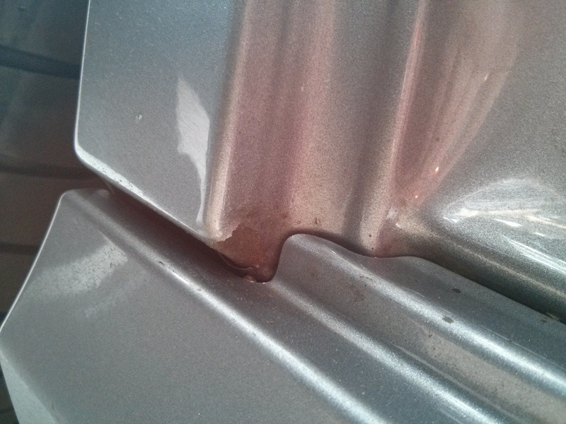

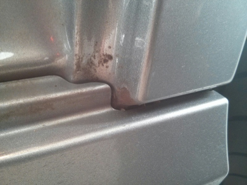

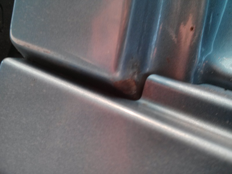

Back at the dealer with the rusty W212 today, and the 250 that i referred to in the original post was still there so i crawled down with my camera to take some shots.
There was also a E350 CDI -2010 with 83 440 km on the meter with the exact same symptom, i took some pictures on that one too.
I have a theory that on the swedish roads they pour small sand/gravel on the minor roads in the winter, the major roads is usually salted.
I think you can notice in some pic that there are small stones between the side skirt and the metal.
This is a fact rust.
I am now a happy owner of a 2013 E220 CDI with just 12000km on the meter with no rust.
I will mount mudflaps and also put some protective film on the corner where i spotted the rust on the other cars hoping that my car will be better protected.
It was worth the wait!
