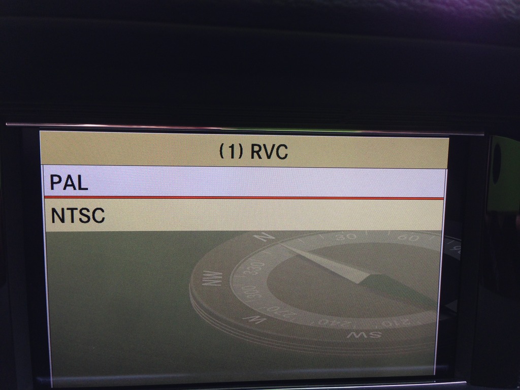

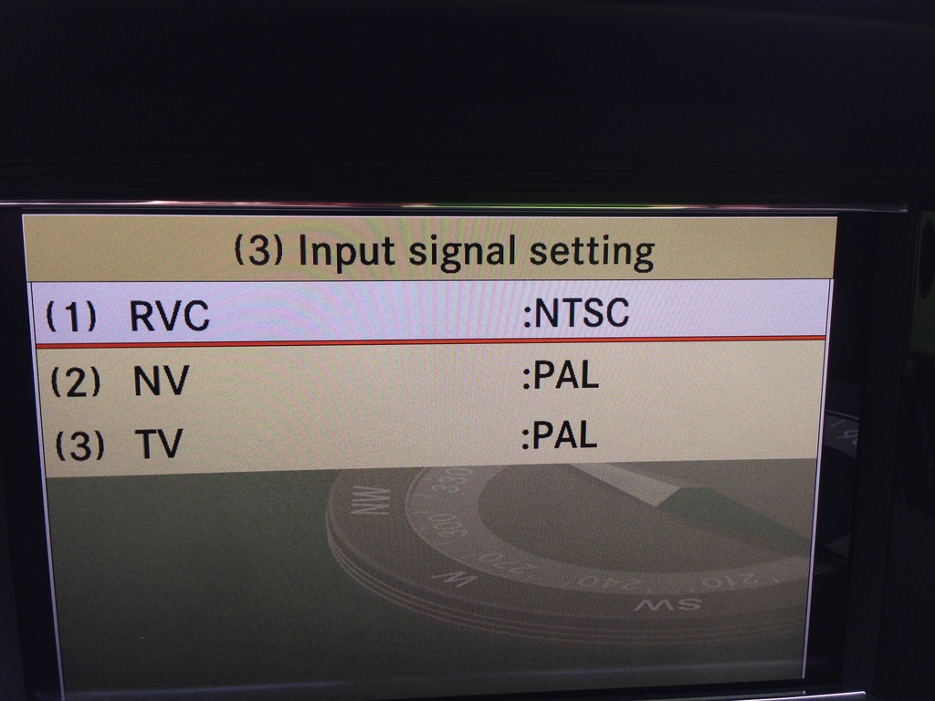

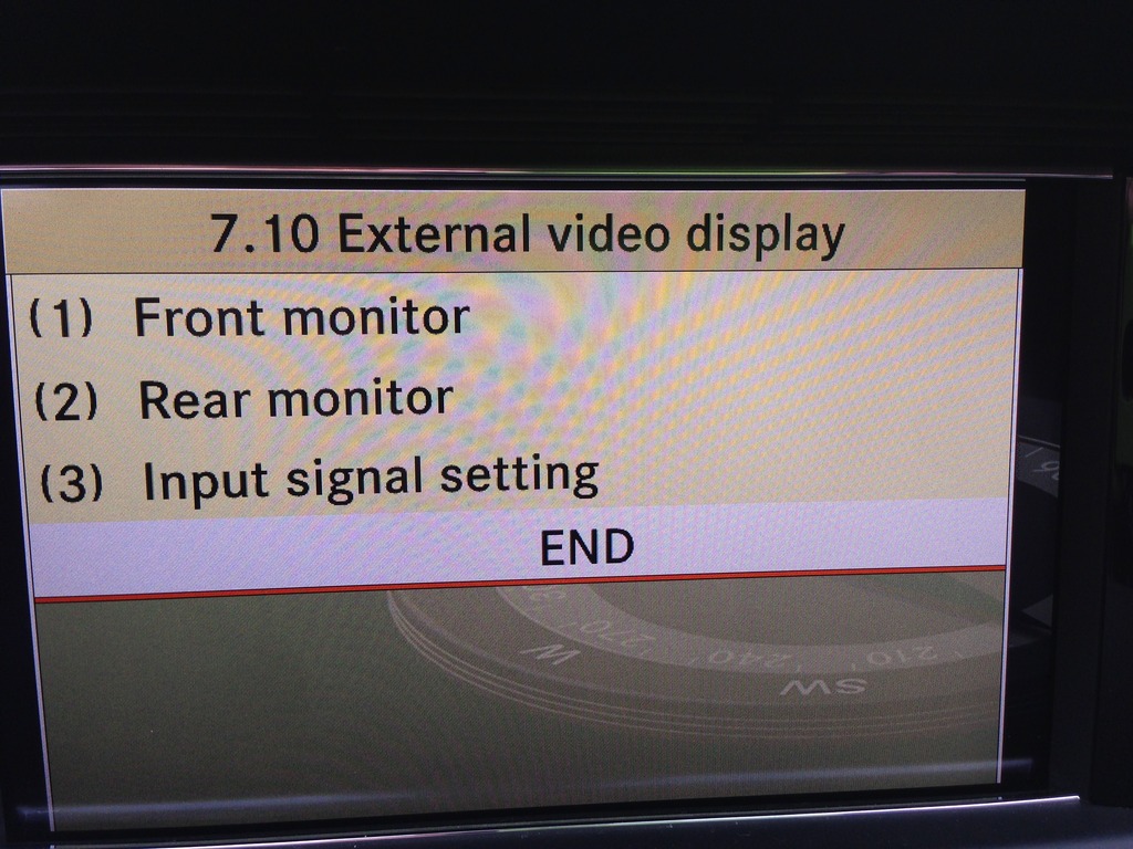

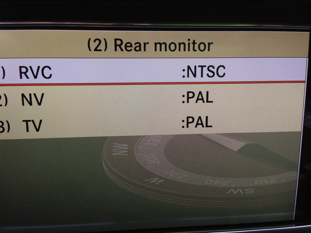

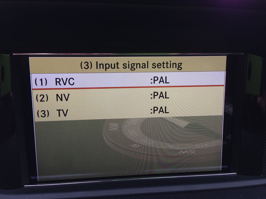

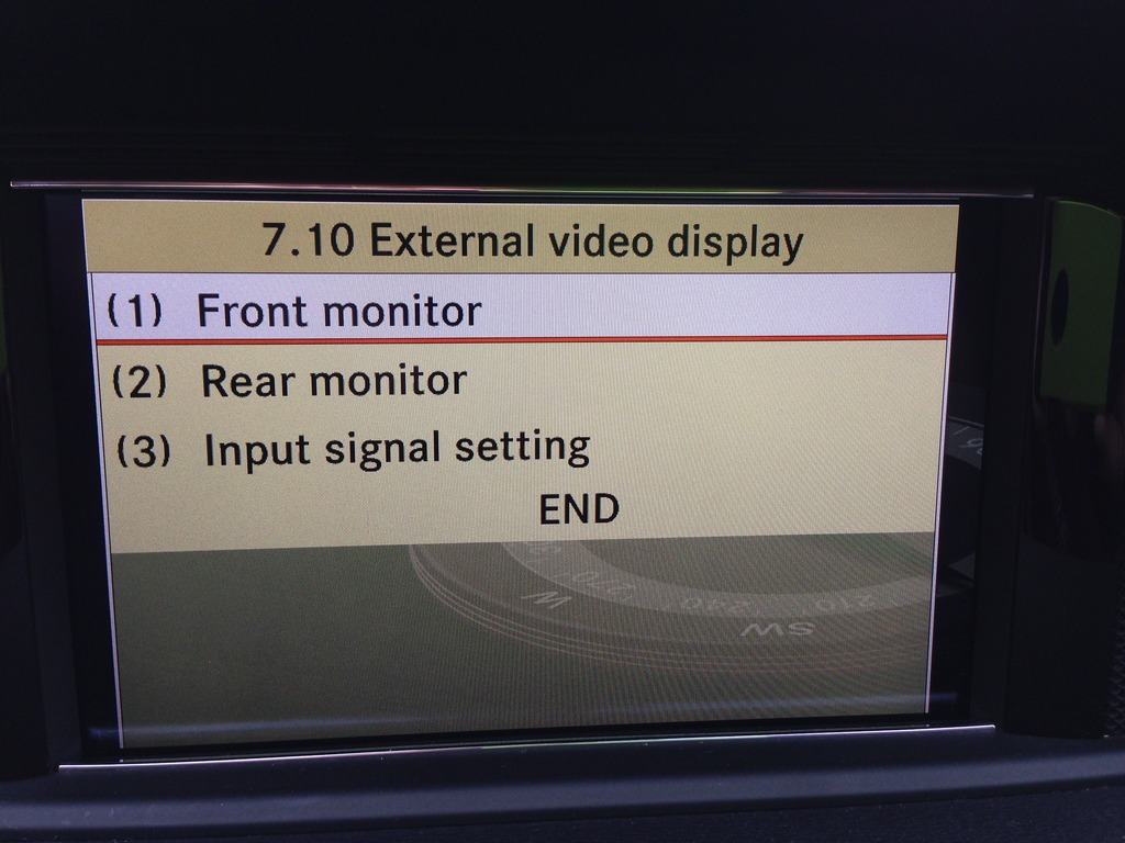

Installing a rearview camera on a E-class 250 cdi Wagon Comand NTG4, and some problems came up.
First of all when i go into Engineering menu to set NTC or Pal it says NTC and then i change to PAL and then go to END, the Comand restarts.
When i go into Engineering menu again it says NTSC, seems like the Comand won`t save my settings.

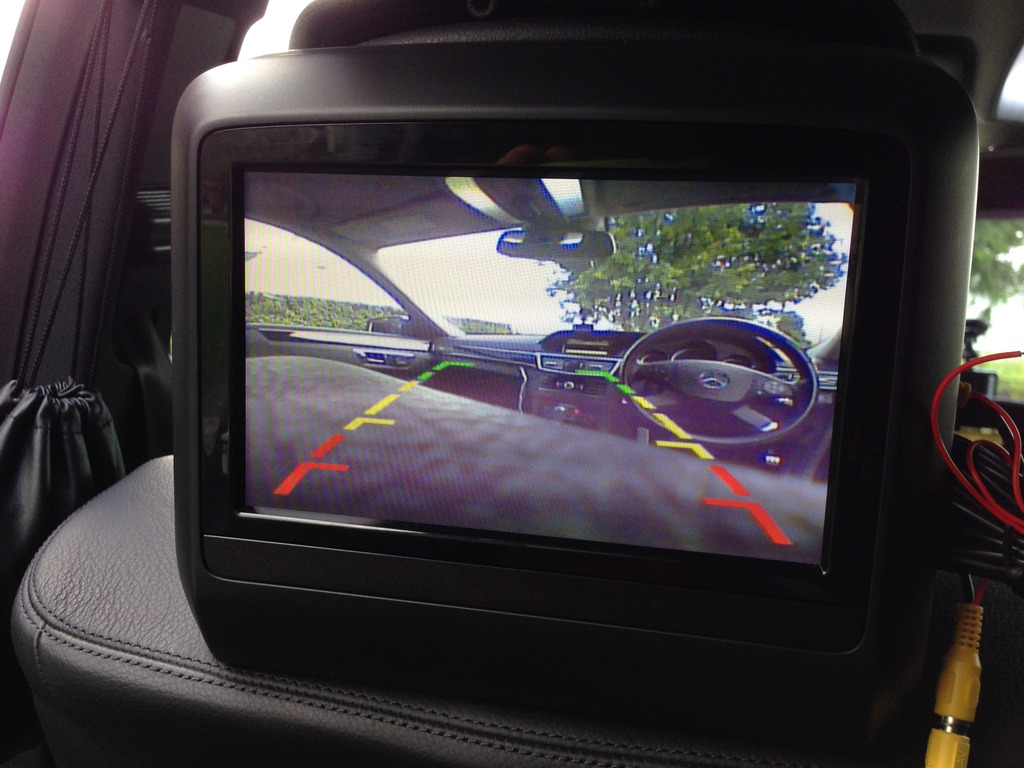

Tested the camera on my rearseat monitors, pictures come up, and the camera works.

What am i doing wrong???
Got 2 cameras i have tested both does not work when i connect them to the comand, only when i connect them to my rear seat monitor.
Thinking about a broken FAKRA cable, but hav measured it.
Also tried to connect the FAKRA cable to both connectors on the Comand
I have the newest Map Update, but not sure if this covers the Firmware aswell.

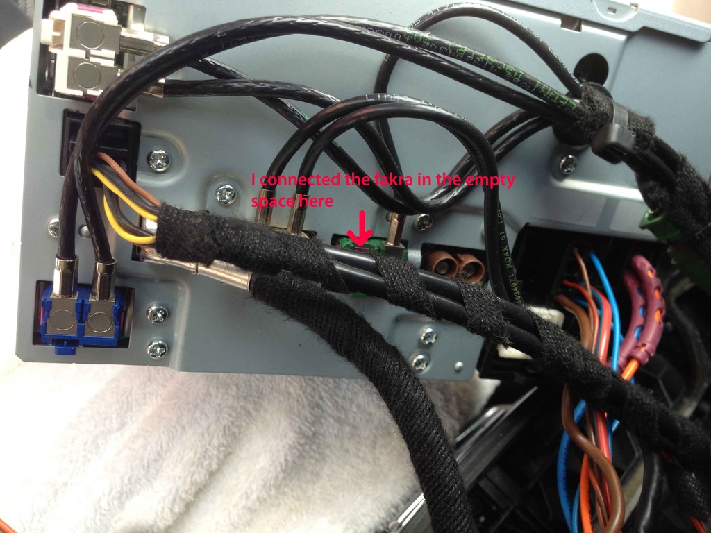

I`ve been thinking alot lately and tested again.
I just switched the two Fakras, to see of that worked, and it did.
I Don`t understand why, but it worked, so far i don`t know if i miss any functions yet

Switched the two Fakras and now it works

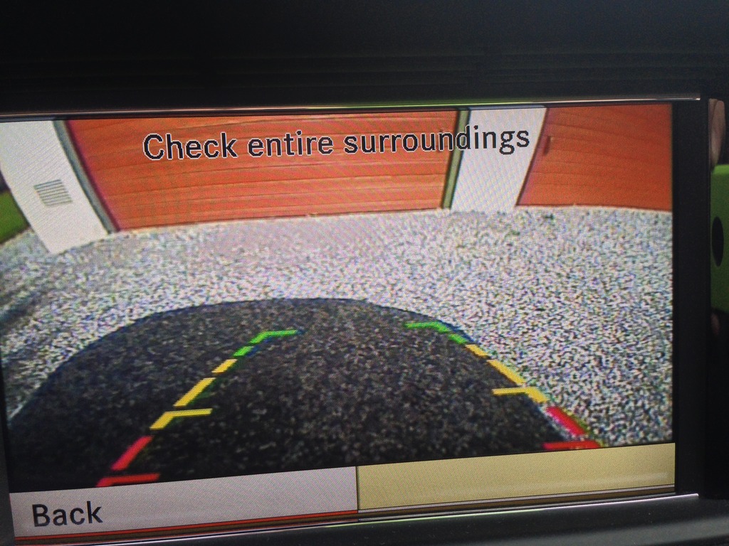

Bravo... now its time for some pictures of the actual screen while reversing. Thank you for the very useful thread.

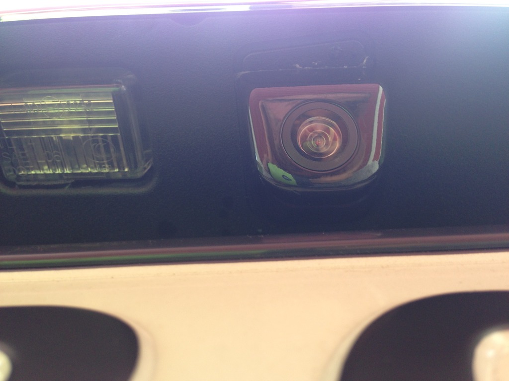

I used this Guide/Thread
https://mbworld.org/forums/c-class-w...der-200-a.html
