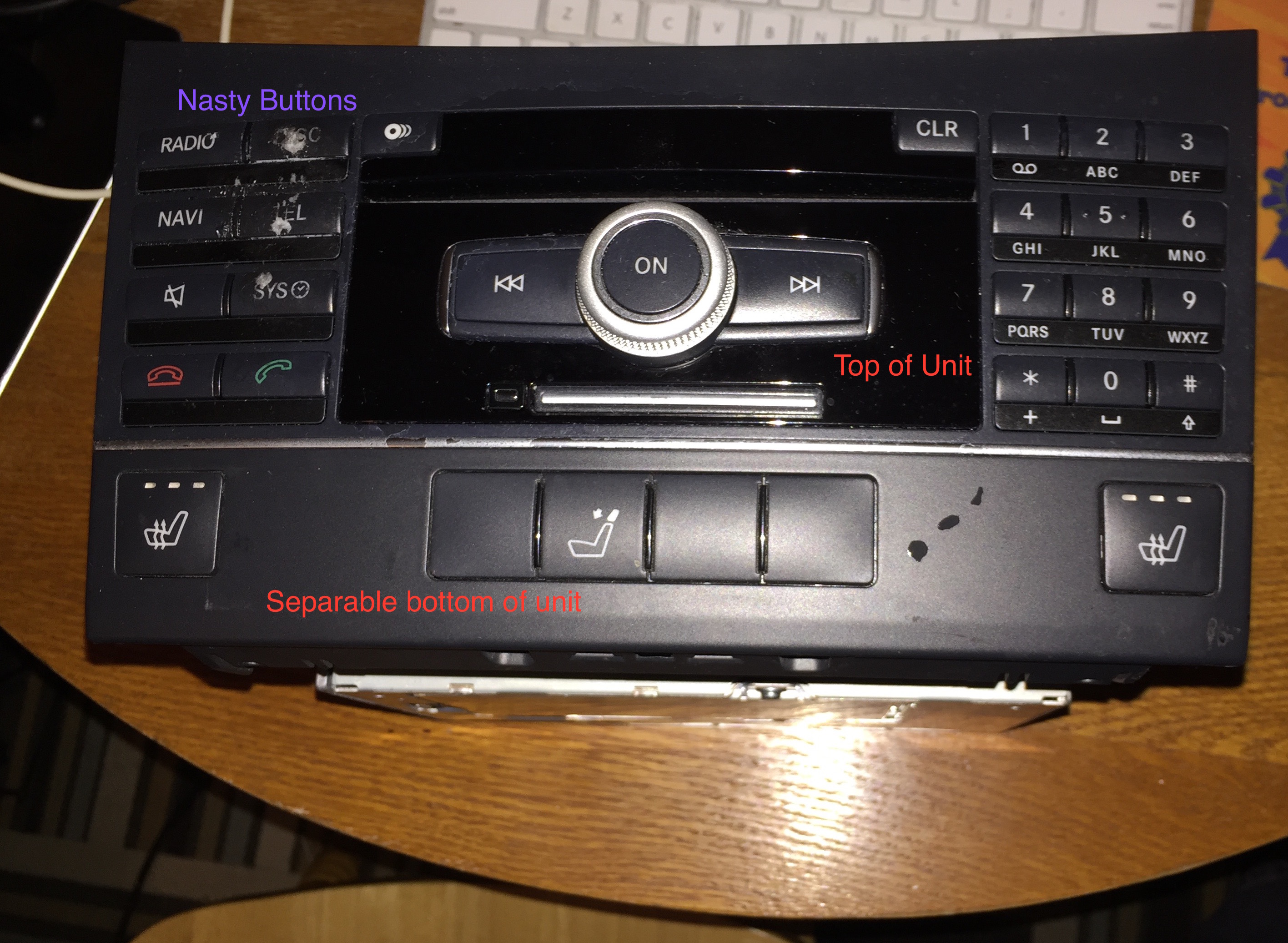

My comand head unit had bad buttons on it. A previous owner had simply fudged up the buttons with something - perhaps hand sanitizer. The unit worked fine but the buttons would stick and the decals were droopy. I recently purchased another unit off eBay to take it apart and see if I can replace just the buttons. I found out that you can.
These units are so poorly documented on forums that I thought I would do a quick write up of my observations. I might add pictures later if requested. The best video for how to pull the unit that I found is
1) The bottom row of buttons (that include the seat heaters) is a separate component and easily swappable with 4 hex screws. When you pull the unit out of the car it is a separate plug on the right side of the unit.
2) The top buttons (8 on each side - volume in middle etc.) can be swapped out quite easily also. It's four phillips screws and a few clips - comes right off. Be careful to line up the PCMCIA buttons when you put the new one on. I made the assumption that a unit with the same buttons would have the same guts and I was right. It lined up perfectly.
3) Three screws on the bottom of the unit gain access to the hard drive. I did not have any luck simply swapping my hard drive with another unit. I imagine they will have to have the exact same versions of software, etc.
4) If the display looks wonky make sure to reseat the metallic plug on the back of the unit - that's the display port.
5) It's essential to view the back of one of these units before purchase. Pull the one you have and take a photo of the back to compare. I saw about 3-4 versions on the internet.
6) My 2011 E350 did not have any protection swapping a new unit (or the old one back) a few times as I played with it. No codes or anything. The word on the street is that they introduced this in the middle of 2011.
